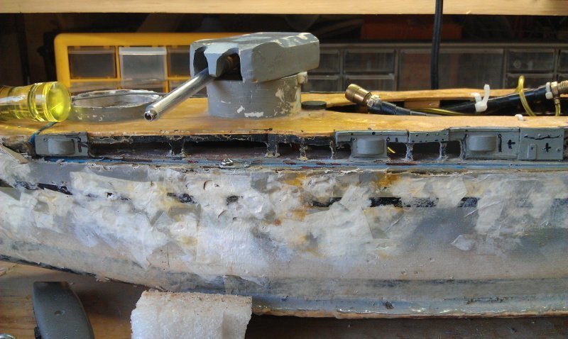

    The SMS Baden pulled into SpudWerks Shipyards for her refit. Jeff Lipp's SMS Baden has been battling in the MWC/IRWCC since 2002.
    For a x-mas present I offered to rebuild her and get her up to 2012 equipment standards.[​IMG]
    In the pics you can see she still has the old reliable servos for gun control and bilge pump. During her refit she will be getting the deck relaid, lighter superstructure, new boards for firing circuts and a rc220 esc. Also will be fitting a autoswitch for the pump.
    Here are a few pics of her as she just slipped into drydock.
    The first issue was with the antenna, it had so many coats of paint I had to strip off the original coating to get it out.
    I love a wire rats nest..... The only straight area was inside the water box.
    Kips too close to the motor... bad for misfires and they always happen at the qwrong time. :woot:
    The rudder system is great, it stays. I wish I could work with stainless steel like that...:crying:
    One of BC's original drive boxes.... it stays, still good.
    LOL, stowing away the stuff...
    All cleaned out and ready... for the dirty work o_O
    Scraping barnacles erally sucks...:sick:
    Tracing out the new subdeck
    Had to grind out the old wood deck in fear of breaking the glass ribs, she is really thin.
    Planning out the sterns.
    Always make sure battery fits...:whistling:
    Looks good
    I sanded and painted the inside of the hull today... Wife is really mad o_O It was cold and I had to keep the shop door closed....:p
    Casement work begins....
    My hand so hurts after cutting all those....
    Well, the deck will be cut and placed on the ship along with the weather deck. Then comes the wiring and placement of internals...
    Stay tuned
