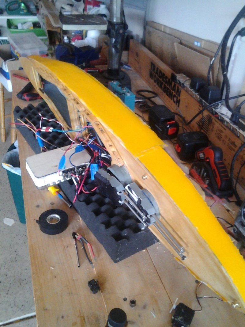

    I know this is an old thread but can the builder or someone in the know tell me what it looks like under the deck of the dual stern barrel holder found on page 3? I’m trying to replicate this screw elevation system. Thanks!
  15. Panzer
    Mar 27, 2013
    633
    Hell, MI
    Hey Litch, I can do better than that I can take pics of it cuz its in my garage, being built to go to Nats.
    IMG_0999[1].JPG IMG_0995[1].JPG IMG_0996[1].JPG IMG_0998[1].JPG IMG_0999[1].JPG IMG_0997[1].JPG IMG_1001[1].JPG IMG_1002[1].JPG IMG_1003[1].JPG IMG_1004[1].JPG
    Sorry the gremlins are pretty active at nite and wanted to know what I was up to, Be careful if you expand those pics they have been known to jump ship before. Underside of the plate that holds the barrals there is a nut soldered in place to lock it in and the screw than just does elevation adjustments. the wood underneath the deck helps support the screw and keeps it from bending as easily as it wood otherwise.:):D:woot: Big shout out to Spudzy for the excellent construction on his part.

    Thanks for taking those pictures, I really appreciate it!
