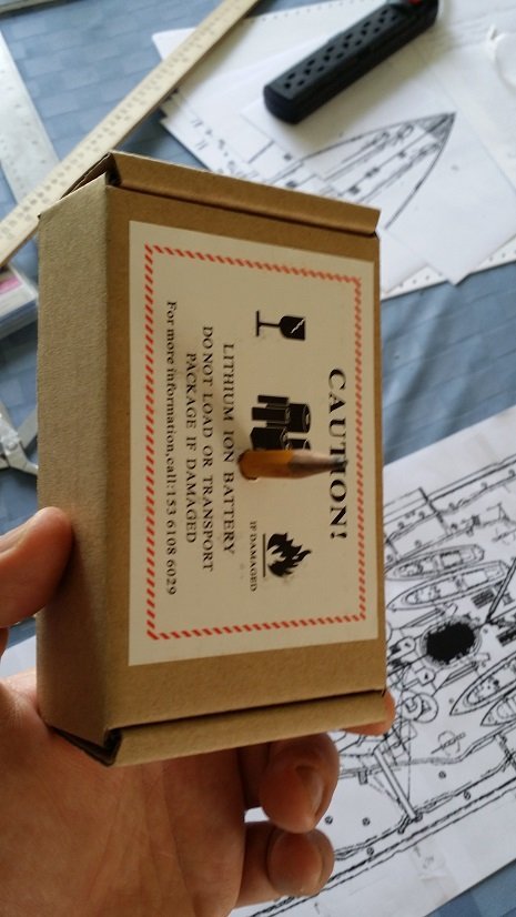

    This past weekend, I was planning to build a waterline marking device similar to the one pictured in a link earlier in this thread. As I was laying out the plywood and planning my cuts, I pondered about the necessity of such a device since, in my case, I'm really only marking one ship. So, I decided to improvise... I jabbed a pencil through a sturdy cardboard box in the way I imagined the monkeys would have probably done at the beginning of the movie '2001' and voila:
    I know it's not pretty, but I think it worked fine.

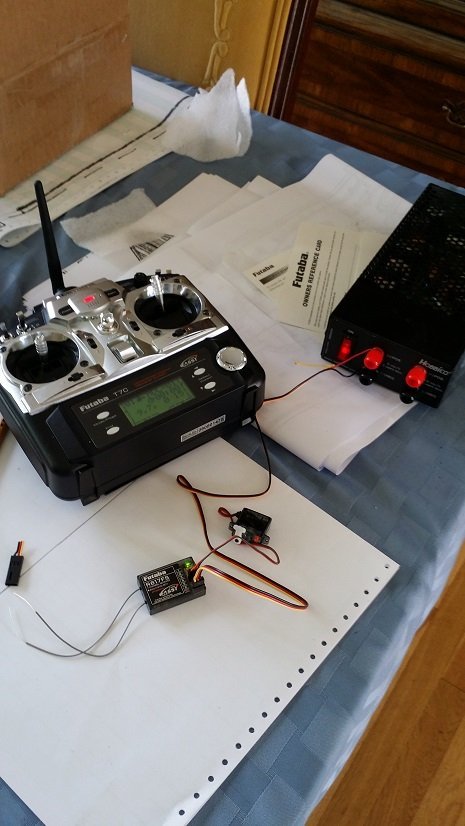

    First, I decided to test the radio equipment (Futaba 7C). After a quick charge of the TX batteries, everything seems to work (which is a very good thing... a new radio would have thrown this project WAY over budget):
    Though apprehensive, I'm definitely considering adding push-buttons to the radio.

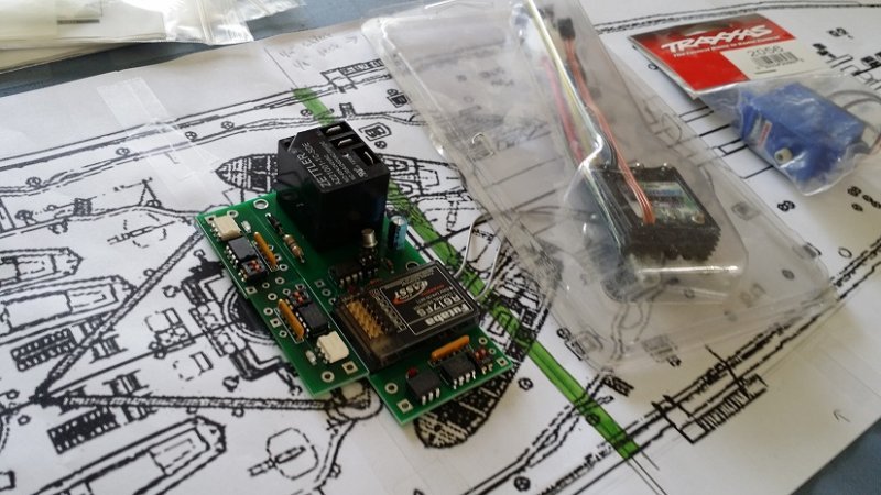

    I also found a few other items of interest and, assuming they still work, will find their way into Bayern. On the left, I have 4 team delta switches (large one for the pump, three others for: dual sterns, stern sidemount and bow sidemount) along with the Futaba receiver. I have everything close together in the photo because I'm thinking of using a Pelican box to hold these electronics (similar to the method described in the 'How-to' section of the MWC website) and I'm trying to judge how much room will be needed.
    Next to the Team Delta switches, in the center of the photo, is a Mtroniks Marine Viper 40 ESC. Although I've read a lot on this forum about the 'brushless' setups, I'm thinking, at least for now, of using brushed motors. Currently owning this ESC, along with about 8 of the Johnson 550 motors and a Stinger pump motor is my main motivation for choosing a brushed motor setup. For those using the brushless systems, how hard will it be to convert if I choose to do so during a later refit?

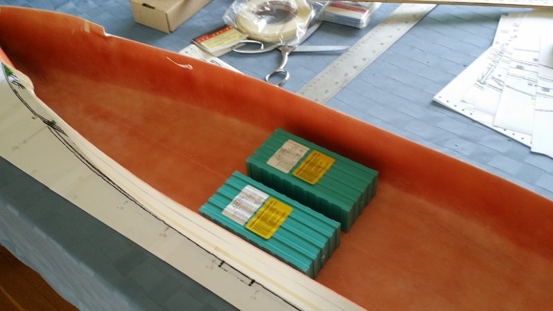

    Two LifePO4 3.2 V 20Ah batteries, which I'm planning to use to power the ship, have arrived and look quite lonely in the empty hull

    I do love the irony of the puncture through a Lithium Ion battery package.
    Anvil_x likes this.
  10. Tugboat
    Me, too, Keri, that was my first thought :)
  11. jpmarino
    jpmarino Active Member
    Jan 7, 2008
    123
    Addison, IL
    Lol! I didn't even really notice... good thing it was empty.

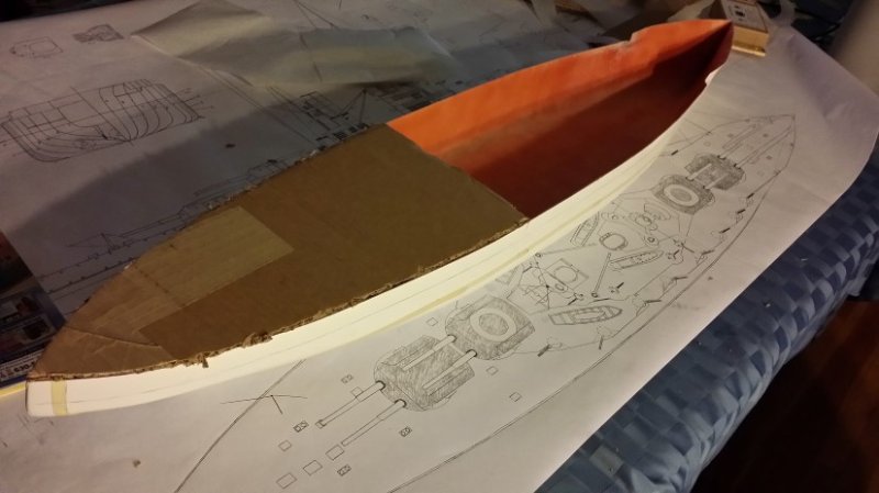

    I received the new set of plans from Loyalhanna today (George Goff plans, to my surprise). So far, they seem to fit this hull like a glove. Perhaps the original prototype was built from this, or a similar, set of plans?
    Anyhow, I using green construction techniques and cut my aft deck from a piece of recycled cardboard. I figure once I duct tape it to the hull I'll be good to go. Who wants to battle?
    I'm only kidding, of course...
    If my calculations are correct, the 3/8" deck begins, and the 1/4" casement deck ends, just after the second to last casement cannon. So, I made a tracing and cut a piece of cardboard so I can mark this position on my hull.
    Thanks!
