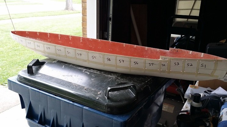

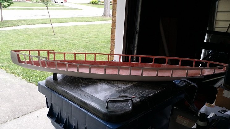

    Holes (1/8") drilled at the corners of the penetrable windows:
    SMS Bayern hull with windows cut:
    On a side note, I seem to enjoy the smell of ground fiberglass.

    Looks good. Make sure the hull hasn't "hogged" (bowed out in the middle) when you're laying out your subdeck & deck. Fiberglass hulls, especially one you've cut the windows, will tend to sag in the middle unless you glue in some supports.

    I think it's already doing that a bit. I cut the rear subdeck today from 1/4" model aircraft plywood and noticed the top caprails are sagging a bit out and down and the center is bulging upwards. However, when I pinch everything together (i.e. subdeck and hull) to the proper width, everything seems to return to normal. I still have a lot of shaping to do on the subdeck and have to cut/install the reinforcements for the ribs, so it may be a while before everything is glued in place. I'll keep an eye on it as the build progresses.

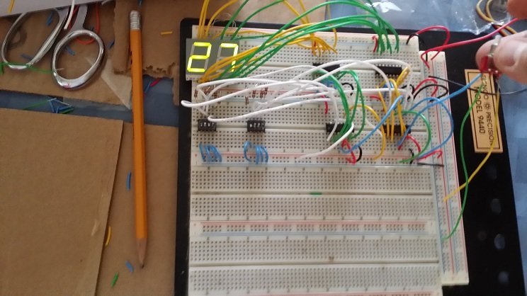

    Back in 2008, Bob in Minnesota gave me the idea for a shot counter to keep track of the amount of ammunition remaining in each cannon during a sortie. This past week, I found the parts in my basement which I purchased back then and was planning to use on the project. I figured if I'm going to open up my radio for the button modification, I may as well resurrect the shot counter.
    This evening, I build a prototype as proof of concept. Sorry about the cleanliness of the build:
    Basically, the two DIP switches allow you to preset the initial value into the counters (0111 0101 for a 75 round cannon, 0101 0000 for a 50 round cannon, 0000 0001 for a spurt gun :laugh:). Then, each press of the SPDT switch (which will be replaced by a DPDT switch in the radio) will subtract one from the counter. Assuming I can get my cannons to fire only a single shot when activated, the value indicated on the counter should be a good estimate of the amount of ammunition left in the cannon.
    A SPDT switch (not shown since I just grounded the corresponding pins manually during a reset) will reset the counter back to the initial value.
    Obviously, something like this (or, more precisely, something like 4 of these) will have to be mounted on some kind of supplementary board and perhaps bolted to the radio... I haven't quite figured out how I'll do that yet.

    1x LDD C812RI (dual 7 segment display)
    2x CD74HCT4511E (7 segment display driver)
    2x CD40192BE (Presettable up/down counter)
    2x DIP Switch (4 pds)
    1x SPDT Switch (for reset)
    1x DPDT Switch (in radio)
    I may also add an optoisolator between the circuit in the radio and the shot counter, but we'll get to that once I get the courage to take apart my radio.

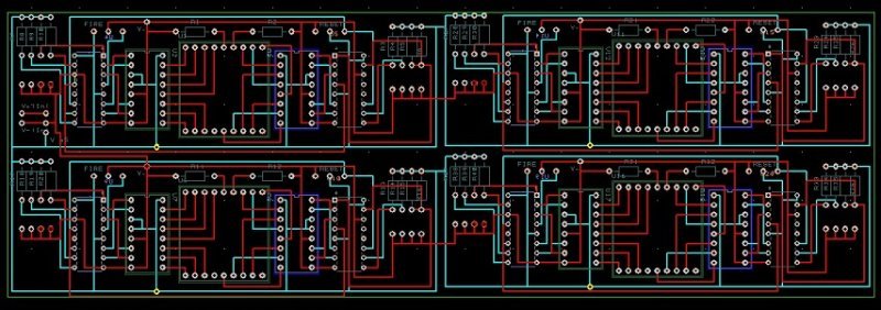

    I played around with a preliminary PCB design at lunch today. I still have to check my footprints, double-check everything is pinned correctly, etc.. Right now, the 4 circuits are approximately 9" x 3":
    Don't worry about it taking time away from working on the boat... I'm at work. Cutting plywood would be frowned upon. :laugh:
