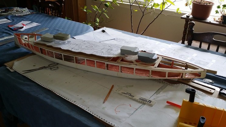

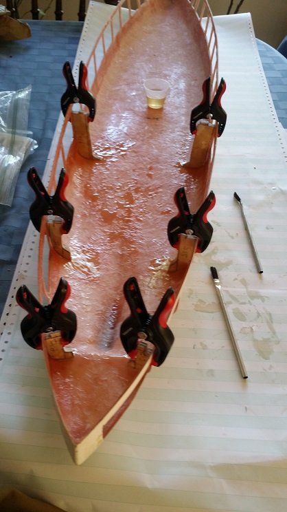

    Sorry, I haven't had the time to post. But, I did work on the following this past weekend:
    Rib reinforcement - 6 down, 28 to go... On a side note, West System epoxy seems much more exothermic than I remembered. I wonder if they've changed the formula.
    I cut/shaped the lower-center subdeck from 1/8" aircraft plywood. A rabbit joint on the stern subdeck is holding it in the rear. The infamous 'holy' LiFe battery box is presently supporting it at the bow.
    That's all for now. I'm going to keep plugging away at the rib reinforcements for the foreseeable future.

  11. rcengr
    Wow, very clean work!
    I stay away from the West 205 hardener these days and only use the 206. On a warm summer day the 205 can kick off and ruin your batch in less than 10 minutes.
  12. jadfer

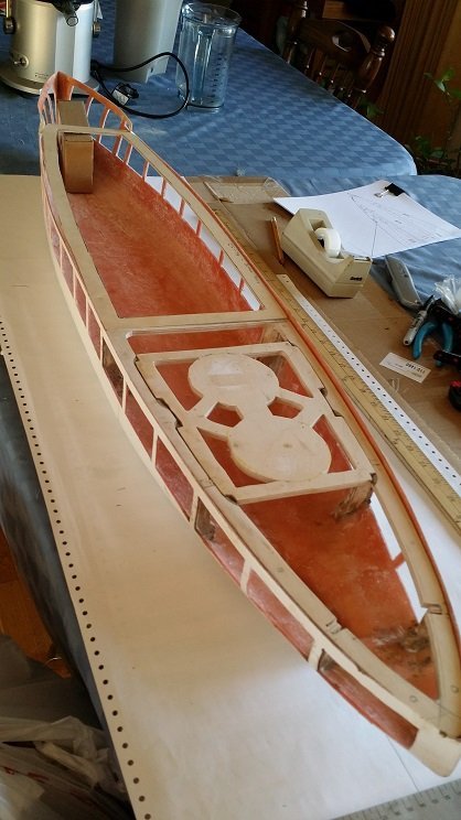

    Hello all:
    Life has gotten busy over the past month or so. However, I managed to devote some time to the Bayern project this past weekend. Though I didn't make any progress with the rib reinforcements, I did begin working on the casement area. I also created the barbettes from 3" OD clear tubing.
    That's all for now.
    Thanks,
    John
