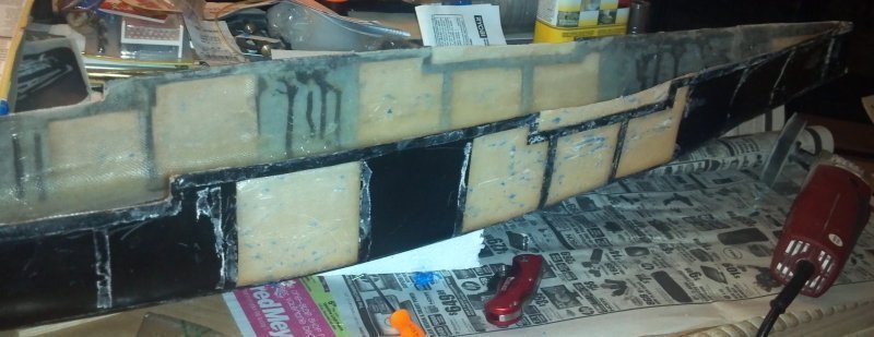

    Finished the hull rebuild the other weekend. It still had some more cleanup to do in this picture.
    Overall I'm happy with how it turned out. The hull has some thickness and strength to it now that it didn't have before and my bluetape and balsa sheeting method did a pretty good job overall of maintaining the hull shape. There are a few high spots but nothing major.
