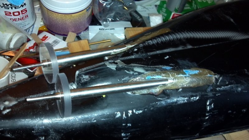

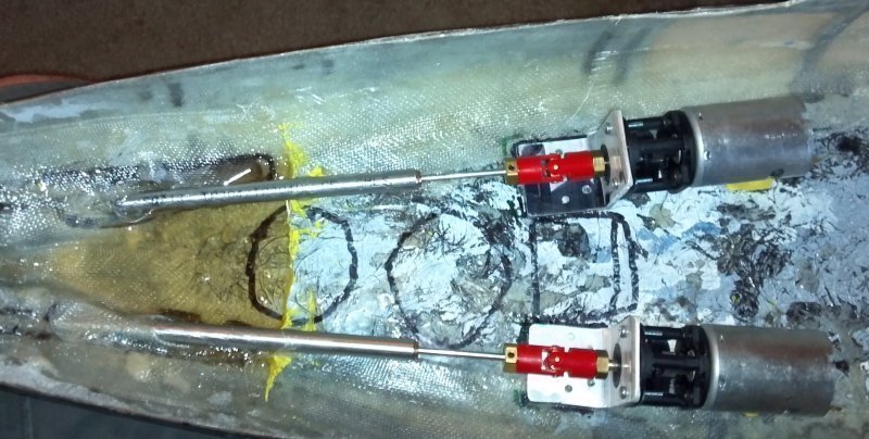

  7. NickMyers
    Lined up the motor mounts and stuffing tubes last night, tacked them in place with superglue and then set to work fiberglassing them in place.
    The yellow is little bits of clay leftover from the clay dam I used to make sure the resin didnt run all over the place and to support the stuffing tubes while they were initially tacked in place.
    First layer is in, which is the layer that seals the opening, time to bulk up the tube support a little and make the outside look pretty.
    Pretty! Did you cut the plexiglass discs yourself?
  9. NickMyers
    Hovey cut 4 of them for me on his lathe last year. Their true purpose was for drag discs but theyre phenomenally useful for lining up the stuffing tubes was well.

    Before I moved (almost 3 years ago) I wanted to make sure the drive mounts stayed where they were and didn't get dislodged, so I drilled through them and the hull and bolted it all together. These holes will need to get re-sealed.
