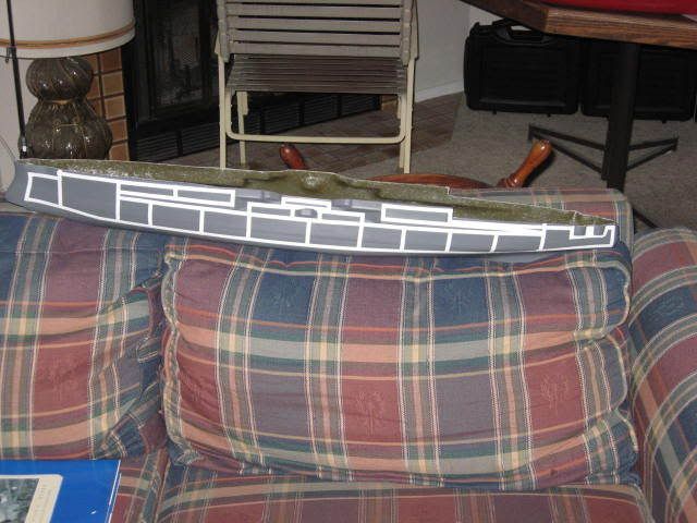

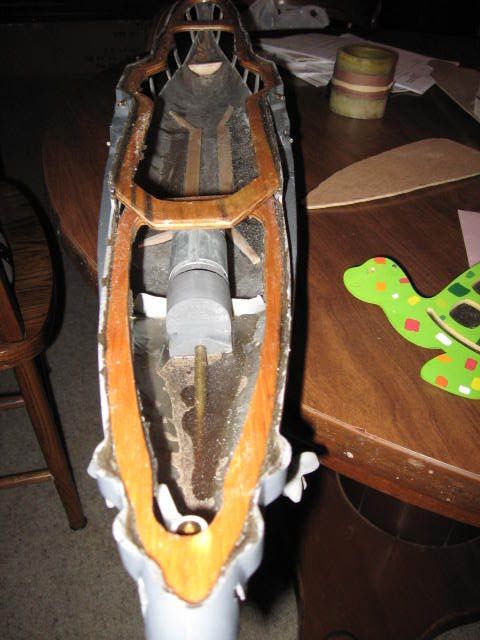

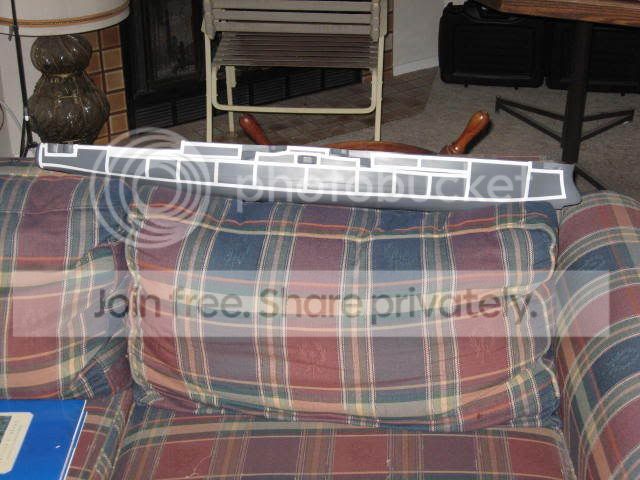

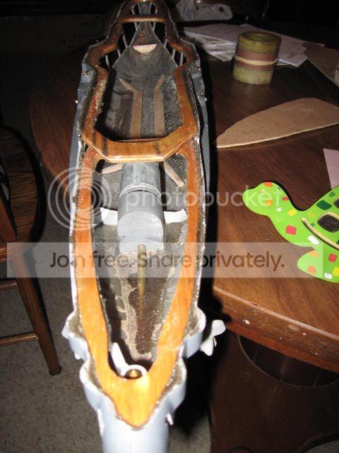

    Hey all, I started work on my little armored cruiser today. Just taped out the ribs since I was helping a new guy get work done on his boat. Here's the pics from todays activity!
  2. djranier
    Wow thats going to be fun cutting up. She has a nice and tight stern also, those gun bulges look like they will help with the steering gear setup.

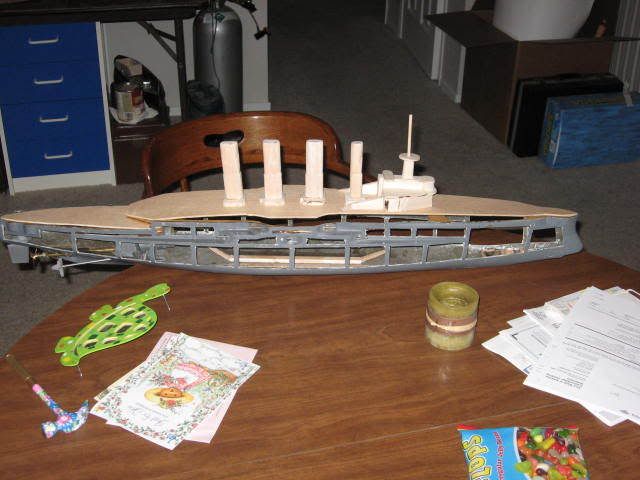

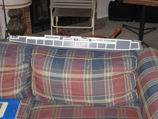

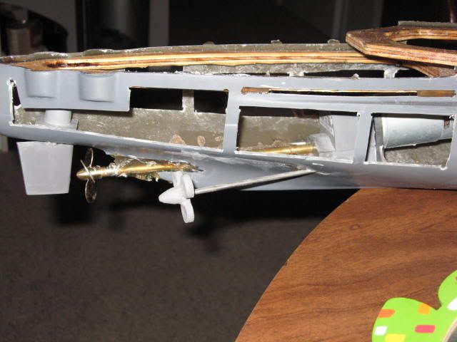

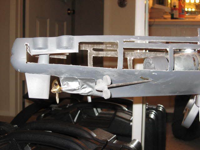

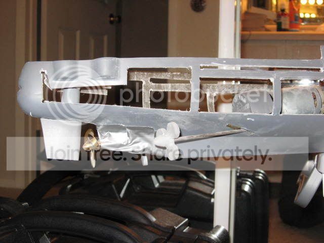

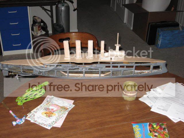

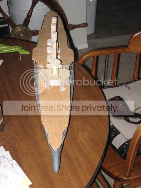

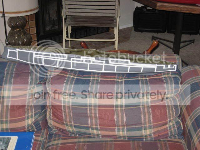

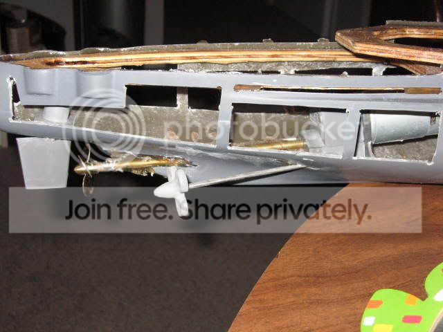

    Here's the progress today! Got lots of work done on the Scharnhorst, as well as a Musashi another club member is building. That's one big boat! Here's a couple shots of the stern section of my armored cruiser. I'm pleased with how she looks so far!

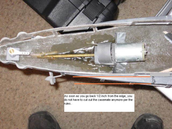

    Did you cut out more than needed? Anything set back 1/2 from the edge of the hull does not need to be cut out. Those large areas that are recessed looks like they should be solid? But hard to tell from the picture really.
    Are you planning on battling her at NATS? For the whole week, or the Wed morning Battle.

    Seems a little strange to me that you would complain about someone having TOO MUCH penetrable area on their ship (assuming that renodemona actually did cut out sections that didn't need to be cut out). I'm rather curious about the really skinny slot in the back there. Is it actually large enough for a bb to fit through?
  9. Anachronus
    Doesn't look like it. I think that area is allowed to be solid under MWCI rules anyway.
  10. djranier
    I did not complain, just asking a question is all.
    He's Axis, I'm Axis, so of course I will help him if possible. LOL. [:D]
    If its over .177 inches, which is sightly smaller than (.1875) 3/16 inch, then it should be cut out. If the hole is just a little larger than (.150125) 5/32 of a inch, then no need to since the BB could not fit anyways.
    So as Kotori ask's, thise little slots also, may or may not, should of been cut out, good catch.
    On my PE which has the same type of casemates, which are 5/8 inch high. When I measure, the 3/8 down for the internal subdeck, and the 1/8 up allowed by the rules for casemates, the slot would only be (.125) 1/8 inch high, so a .177 BB could not go through, unless over time the solid fiberglass finally started to give way around the edges, which was why I did not cut them out.
    But he can allways add it back in if he finds that he did not need to cut it out. Just more work for him is all, [;)].
  11. Renodemona
    Thanks Bob! I bought those shoes at 2006 Nats at the walmart there because I lost my other ones somewhere in the pond. As to the tiny slit window, a BB will fit through it...barely. It is cut that way per Bob's suggestion. I figure better safe then sorry. The top windows are larger than required, but not by much. It was just easier to cut this way and really the small hard area I might have gained is pretty insignificant compared to the casemates and other such things. :D I mean, I dont want the allies to feel bad when their shells bounce off my tiny little cruiser's hull. ;) I'm building her as my campaign ship, she'll have dual bow guns for shore bombardment and hunting convoys. Locally, I might just putt around with her. I'm sure some big bad battleship will run her down at Nats, but, that's all part of the fun. :D

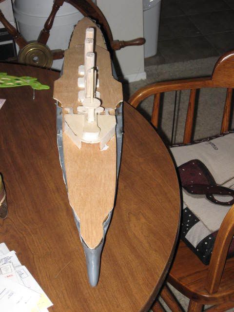

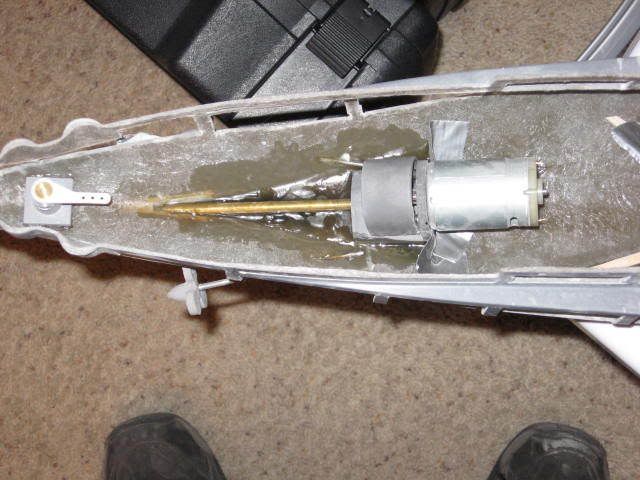

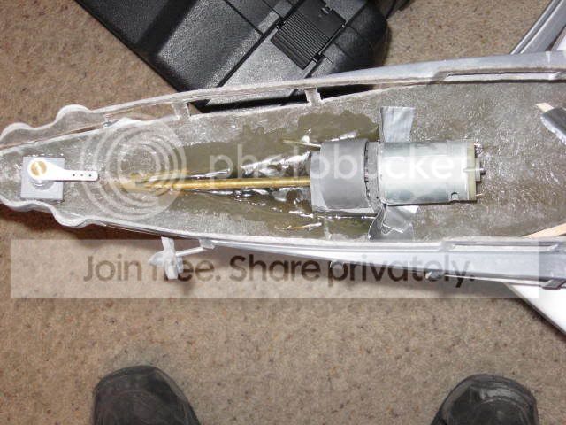

    Big build day for SMS Scharnhorst!
    She will mount dual sterns with a 1/2 unit pump. Not sure where I will have the outlet, probably in the step somewhere. Maybe in one of the 88mm gunhouses.
