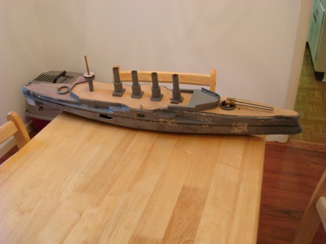

    Scharnie did well operationally at the Brouha on the Bayou, but I was unhappy with the power of the guns. I was also thinking that there were several things that could have been better laid out, and that the pump needed a proper mounting that didn't allow it to get cocked to one side, hindering good priming. Oh, and the near-total absence of superstructure was a nagging issue (altho, admittedly, I am somewhat infamous for deploying 'aircraft carriers' so this is not really a new complaint). SO... Having got some time this weekend, I got Brian K to come over and school me in the dark arts of cannon building, which he in turn learned from the estimable Bob H one night of the Brouha whilst this author was sawing logs to drown out the noise of the dremel :) By the end of the day on Saturday, I had two good cannons that made crazy mad popping noises and recoiled nicely in hand.
    So, to Sunday. After returning from the early church service, I got in the shop and ripped out the mess around the pump, and cut out the bracketry for the CO2 bottle. The gas and electrics had been removed already. A new bracket was fabbed for the bottle, which let it mount with the bottom of the bottle pointing forwards and the regulator end upwards and aft. This freed up much room amidships (pics of this tomorrow) where the pump switch, ESC, and gun servo will be better mounted. A decent plywood mount for the pump was fabbed up and installed, so that I will not have priming issues any more.
    I added the stern superstructure (the part at the step of the deck), the remaining smokestacks (she went to Brouha with only one, the other three forgotten in my shop) were installed, and the deck was masked off. The SS looks great in grey instead of wood-color :) Still have superstructure work (small buildings and fwd mast), and some minor replumbing of the gas lines. Below are some pics after my labors, with Inspector Tuxcat of BuShips assessing progress thus far...

    Nice looking ship Clark! The superstructure really adds something to that ship. :)
    Thanks Mike, I'm alot happier with her inside and out now. The new guns and the internals are the major beneficiaries of the refit. She should be good to go after next weekend (2 more days of building time). Easily ready for the May battle in Pooler.
