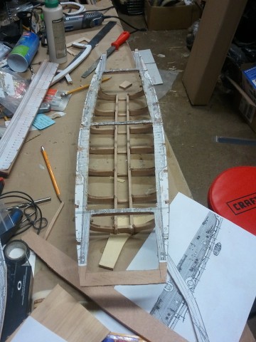

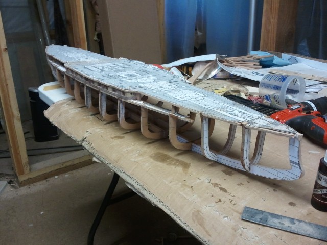

    Trying to get this done before end of summer. My little workspace gets messy and stays messy.

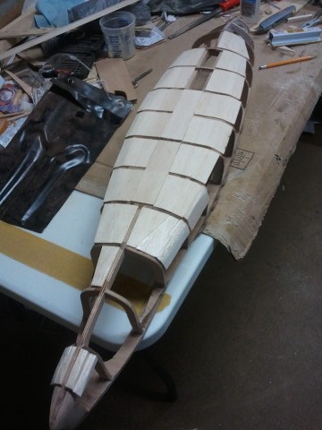

    Start of build or at least where I had a camera available.

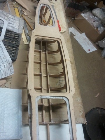

    Little bit more done.

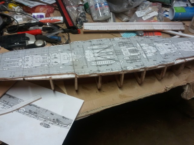

    Where I am now and out of balsa. Wish I hadn't used so much on my other two ships.
    Pretty! I love a good wood ship :)

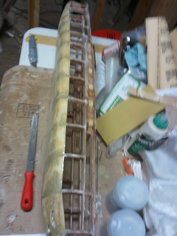

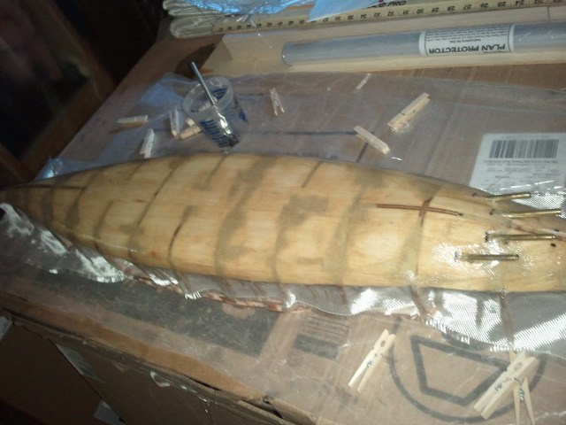

    First coat.

    Wish I had a better camera then my old phone. It works though.
  6. Swiss Cheeze
    Swiss Cheeze Member
    Aug 23, 2013
    98

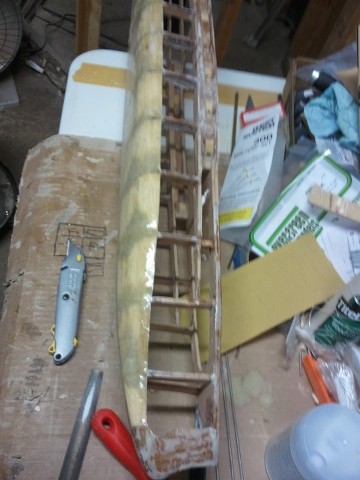

    Thanks. Hey I know there is links and pictures for laying the fiberglass. I was just wondering if anyone had a good method for fixing issues in the fiberglass like bubbles and such. I have been cutting them open or sanding them down and then laying some more epoxy over the top.
  7. jstod
    are they bubble bubbles or just bugles you can sand down? For bubbles I use the method you described except i sand them down instead of popping them open. as far as i know not much more you can do once the stuff is hardened.
  8. Swiss Cheeze
    Swiss Cheeze Member
    Aug 23, 2013
    98
    Yeah I have been sanding down both. I guess I can always cut a piece to put in an empty spot and lay it down. Hopefully have it done tomorrow and on to more exciting stuff.
  9. NickMyers
    If they bother me I cut them open, sand/grind them down and patch them back over. Otherwise I ignore them. Usually I just try to squish the bubbles out. Little ridges and bumps in places balsa doesn't have to stick don't bother me.

    Thanks for the input. Yeah I started sanding and if it came up I just laid some epoxy in the hole and pushed some cut up fiberglass into the mix. Should be over done by today.
    Thanks Beaver. 3rd try so I am getting more practice in. Now I just have to complete everything else and quit making the lower portion of ships and moving to the next.
