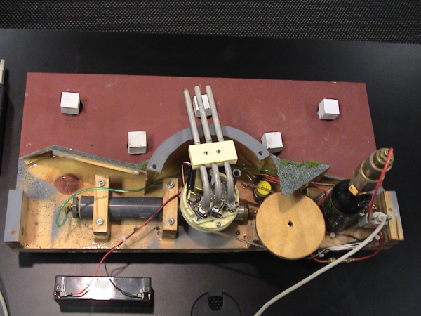

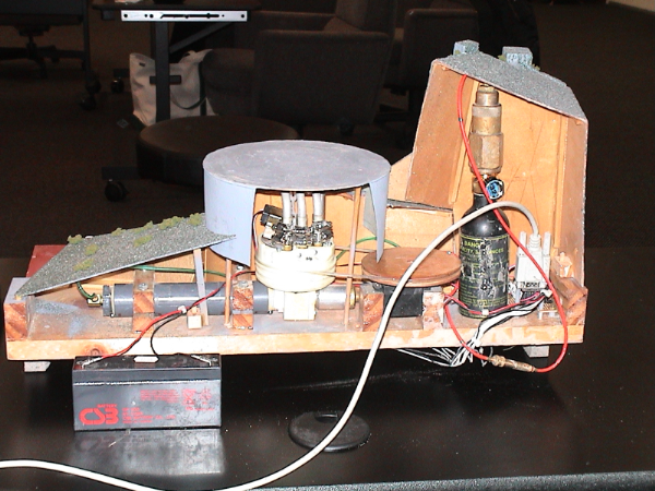

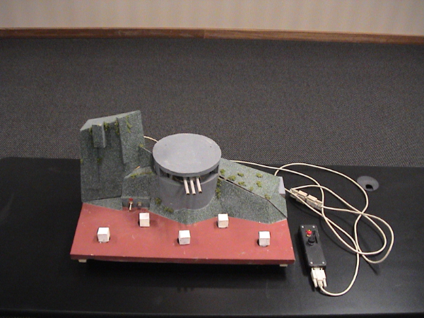

    I've got some photos:
    The weapon is an old BDE Predator (?) 7/32" triple that I didn't have anything else to do with it (I gave another one away on the condition that it also be used for a shore battery, but that never got done). The white cubes are sitting on micro switches. Shoot the block off any switch & the reload timer has another 6 seconds added to it (6-second reload timer is enforced by default, with all blocks in place). All the "brains" are in the hand-held controller, which includes a slider for range, knob for bearing, pushbutton to fire, red & green LEDs that light to tell whether the gun is ready to fire or not (red while in reload, green when ready). "Fire" button is ignored during reload time. In 1st photo, you can see the green "Ready" LED lit, just above the red firing button on the controller.
    Sadly, I don't have either schematics or source code. I think they got lost along with certain other related stuff on a croaked laptop.
    JM
