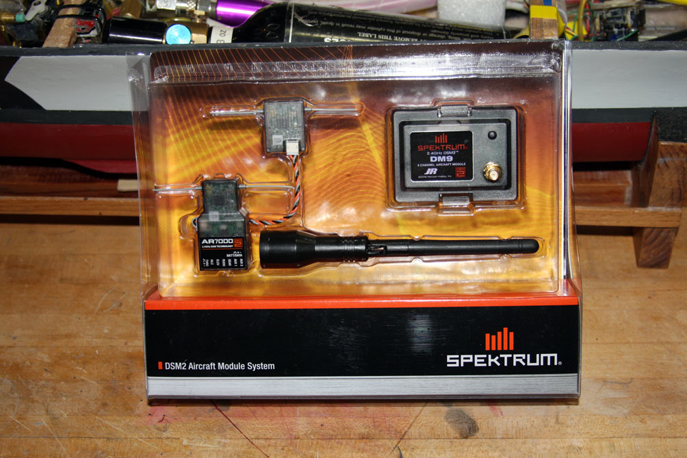

    Packaging
    The equipment comes packaged tightly, and well-protected:
    I ordered the 7-channel AR 7000 module ($99.99), figuring I wouldn't need to spend the extra money ($79) for the 9-channel RX. I saved money, but the 7-channel comes with the "SmartSafe" fail-safe only. The SmartSafe fail-safe lets you decide what throttle setting you want the radio to default to, in the event the receiver loses signal from the transmitter, and the other channels keep their last positions before signal loss. This is handy for the throttle, but I would rather have had the option of pre-setting all of the channels for neutral - a feature available in the 9-channel module AR 9000, but not the AR 7000.

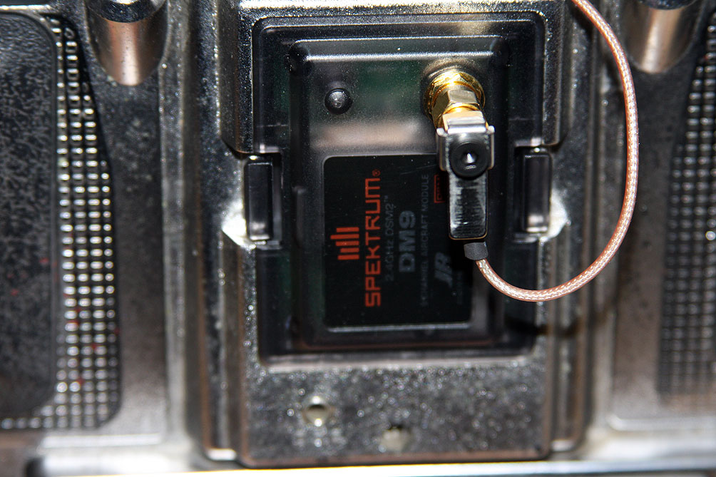

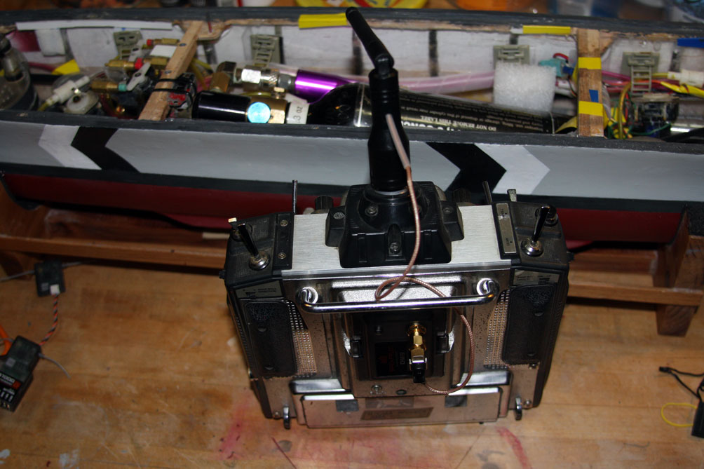

    TX Conversion
    No permanent TX modifications are required to use the 2.4 GHz module, and no mods are required inside the TX case. There is a cable that runs externally from the TX module to the antenna, but it doesn't get in the way, and it's very toughly made.
    To install, screw in the supplied TX antenna adapter, and then slip the 2.4 GHx antenna over the adapter. Insert the plug-in module, and screw the cable fitting onto the post.
