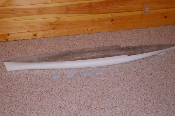

    My HMS Hood hull arrived from Ralph. It looks great.
    Bob Pottle has supplied a set of main turret covers. Thanks again Bob.

  10. Bob Pottle
    The Hood mold is still for sale if anyone's interested. I'm waiting for Tugboat to return the turret mold, but if necessary can make another mold from my one remaining turret. The Hood mold was professionally made from my plug by a local fiberglass company.
