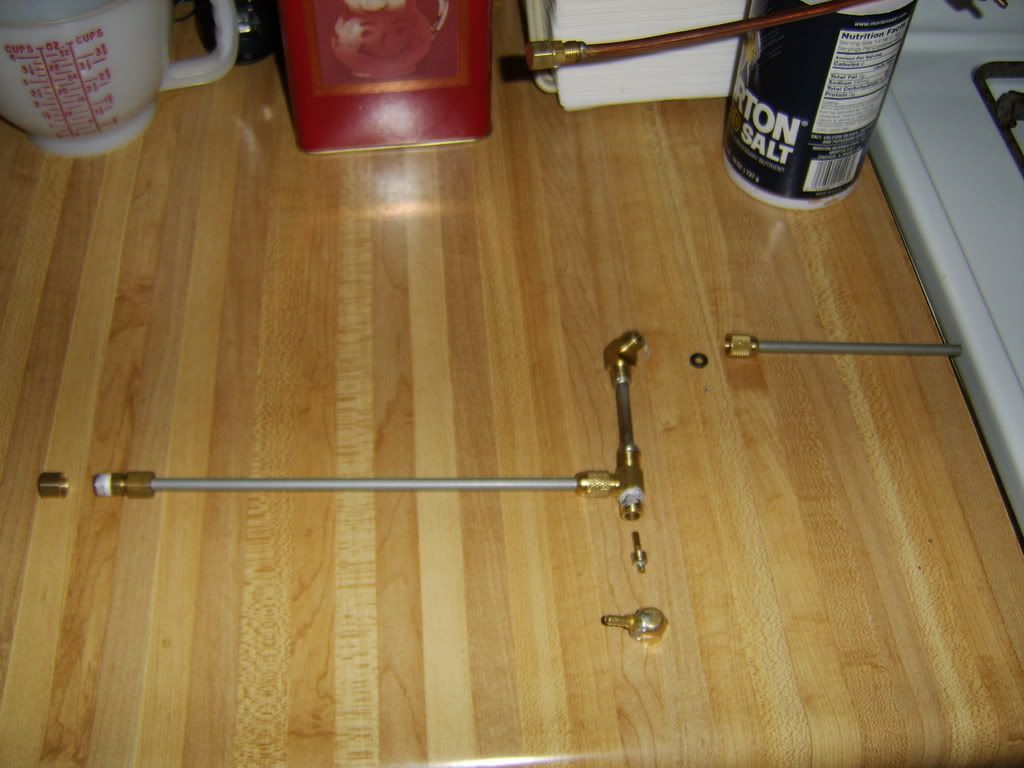

    I've rolled some piston interupter cannons and they have no springs. However I've just got them fireing from a popet valve and I don't have any air line going to the mag either. I used brass tubing and a nickle plated coller soildered to it to make the piston and polished the chamber the piston rides in and they havent jamed in aprox 1000 bb's for each gun since I got the bug's worked-out. BB's every where garage, driveway ,front yard ,back yard. You name it there's bb's there LOL. I have foam board thats as hevey as ply wood.hehehehe They go through blue dow board 1 1/2" at a range of 5' but when I tighten the o-ring further they will almost go 3" but rate of fire is super slow. (1 1/2"is plenty of power I'm guesing)never battled. I'm sure oyu guy's are already went through all this so please tell me should I use a valve with more flow capacity than a popet from battlers connection/are they ment to be used as a fireing valve? And if I were to use silenoid would I need to just start over from the begining or can I use them to fire my cannons??[​IMG]
    Nice looking cannon, Steve :)
    If you're using one poppet per gun, you'll be fine. If you later decide to switch over to solenoids, you just disconnect the hose from the poppet and hook up the hose from the solenoid :) Piece of cake, don't sweat it.
    When you say that the rate of fire is super slow, is that only with the O-ring tightened a lot, or is it just a low rate of fire all the time?
