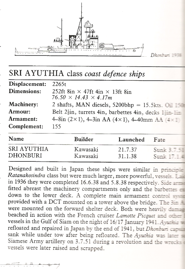

  4. HMCS
    HMCS Active Member
    339
    Not sure of any links, but the class is listed in Conways with a side view line drawing.

  9. HMCS
    HMCS Active Member
    339
    Curt that's the entire Conway's entry,it's a bit cut off but since Bob wrote exactly what they have for info I wasn't too worried about the text, just getting the picture big enough. Haven't tried doing a web search yet though.

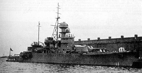

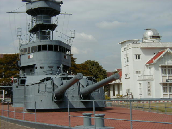

  10. Jay Jennings
    I was able to find these
    Hope they help.
  11. Bob Pottle
    Jay,
    The top photo is a memorial at the main Thai Naval base. It's the salvaged bow turret and bridge of the Dhonburi set on a mocked-up deck on the lawn.
  12. Jay Jennings
    Really? Crap, I had a larger, colour photo of the same thing, but that one I knew was a memorial. If I can salvage it from the trash can I will put it up too.
  13. Jay Jennings
    Here is the other picture. As you can see, there is more structure shown in the smaller picture, which is why I chosse it.
  14. Bob Pottle
    Jay,
    I found an entire web page in Thai with that photo and about a dozen more showing exterior and interior turret details.
    Had a closer look at the hull and mold last night and realized from the construction it must have been one of my early projects. The unfortunate thing is that the plans I'd bought were not great and the stern shape is way off. The small coloured plans you posted show a sharply tapered stern, which is a good match to the one stern photo found. The plans I used had a wide bluntly curved stern.
    I've sanded the stern area to reshape it as much as possible but the improvement is only slight. Oh well, I'm not about to make a new mold because of it. I'll put lots of gelcoat in the stern during lay-up so the hulls' sterns can be sanded a little sharper.
