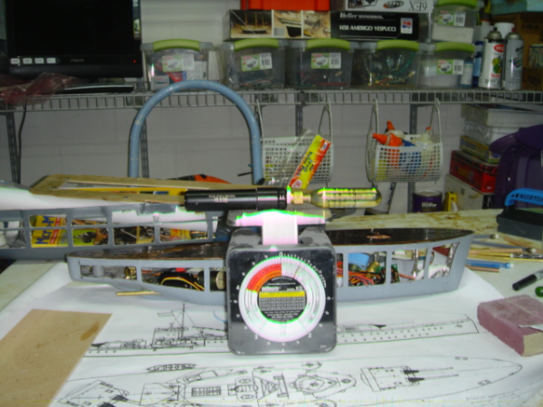

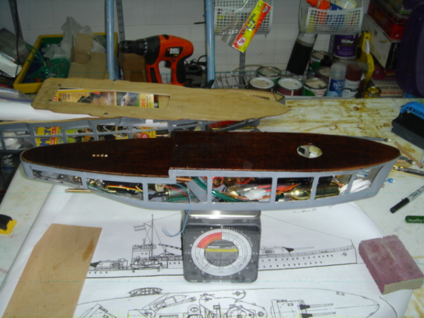

    Here she is with everything except for the Super, she weights right at 3 pounds 1 ounce. Getting close, the super will have to be super light.
    Here is a picture of the regulator, adapter, and 16 gram bottle, together it all weights 7 ounces.

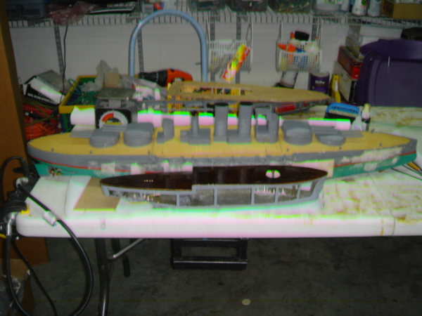

    Here is a picture referencing the SA to my PE, which is also a small class 4 ship.
  4. BoomerBoy17
    my point exactly : )
    My graf spee is what 53 inches? i bet it dwarfs boths of your ships.

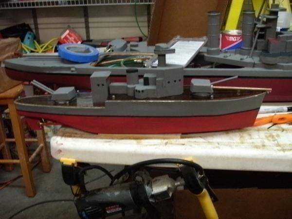

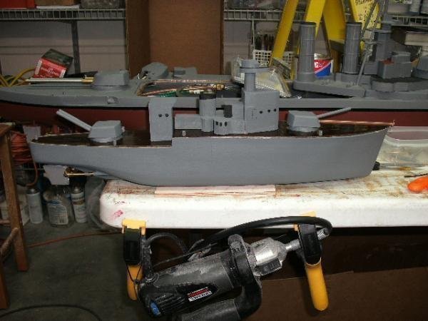

    Well My Daughter and I worked on the Sri all week, and she is just about done. Just needs some touch up paint, add the waterline, and put together some battery packs for her.
    As of now she weight's right at 3 pounds 1.5 ounces. So I have almost 2 ounces left. Just enough for the red paint, and waterline tape I hope, LOL.
    I did float her, and she rides super nice, but seem to be a bit high out of the water. I should of sanded down the top deck edge's around 1/4 or so. But it should not matter, will make her harder to sink. She has a single shot 25 round bow gun installed. The barrel reaches right to the forward deck edge. The port rear 8 inch gun is where the pump outlet is installed. So it will look like it firing out of the gun.
