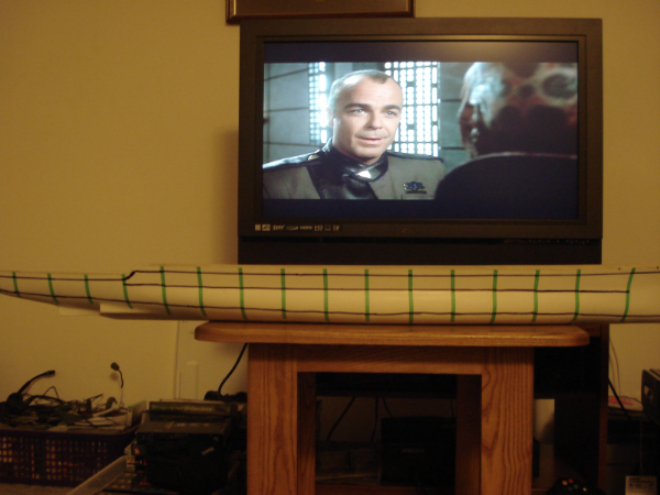

    ok so im starting my Admiral Graf Spee asap seeing that new jersey is a bit big till i get used to combat so im gonig to get AS and glatton on the water now. i just owundering if my hull marking looks good?

    It looks about right for rib and stringer locations. Did you calculate the allowed impenetrable area using 15% of the LOA? The area for ribs is that figure less 2" for the bow and 1" for the solid stern areas, then divide what's left by whatever width of rib you're using to get the number of ribs. The bulge stringer can extend one rib beyond the point where either end of the bulge is no longer prominent.
    Are you using 1/4 ribs or the standard size of 3/8ths?

    im using 1/4 i don't get a good rib count with 3/8 and i dins it easier to use the 1/4 for sheeting.

    That is a nice looking hull. I have always used 1/4" ribs on my boats. Gives you a better looking hull after sheeting.

    On my Invincible I alternated 3/8 and 1/4 inch ribs, which seemed to be a good compromise.

    I've never used 3/8" ribs because I don't like to sheet across 'windows' more than 2 1/4" wide. If necessary I'll use 3/16" ribs but only if the hull is thick so the narrower ribs won't be too weak.
    An exception is the tiny, light weight Sri Ayuthia hull. At 21" long the only way to get enough ribs to sheet it properly is to reduce the impenetrable bow area to 1" and the stern area to 3/4", and use 3/16" wide ribs. Of necessity (2.7 lb wt. limit) the ribs are less than 1/8" thick.
