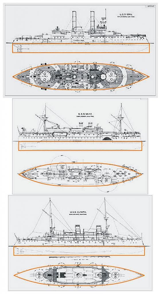

    Example of the "curve" concept.
    Here are examples of a predread battleship, armored cruiser, and protected cruiser (Iowa, Maine, and Olympia). These are scaled relative to each other. Notice that in the overhead view they all share a balanced double-ended canoe style hull which I think is fairly typical of ships of this era. The waterlines of each are outlined. What may not be apparent is that the only ship I traced the waterline on was the Iowa. The other two are the Iowa's tracing but scaled to fit the length and beam of the cruisers. Pretty cool how the scaled tracing closely matches the other two ships.
    The side views represent the same draft for each ship. At 1:96 scale the draft's as depicted would be 3".
    So the concept of a standardized hull form is based off of a set curve which is scaled to fit a particular model. In the example, the curve off of the Iowa is used as the standard.
