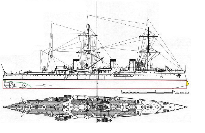

    Speaking of which, brings up a question I've been pondering on for a while. With basic box hull under the water, does that eliminate the ram bows? (yellow area)
    Like seen in the photo.
    So if I build a totally slab-sided hull (i.e. cut out the caprail and keelboard identically), and then decorated to taste, I'd be okay?
  3. Anachronus
    Should be.
  4. SteveT44
    Since the proposed bow is going to be plumb, my thoughts on this is that the ram section would be replaced by a metal penetrator bolted to the bow. This allows us to regulate the size and shape of the ram and it would be removable for times when ramming would not be allowed. Think of a little metal tab attached to one side of the bow that protrudes a bit forward with a triangular shaped end. The ram could be sized where it could be a decisive blow but not necessarily an immediately fatal blow.
    On ramming, to keep PC's from running around and continually ramming, my thought is to add a timeout period for the rammer where they could not move or shoot. In addition, ramming would only be sanctioned when it was two on two or more. With such a setup, the implications requiring teamwork and thought as to when or if to ram are self evident. A captain would be foolish to ram unless his teammate was backing him up.
  5. SteveT44
    I think the consensus on this is that if you build a "stock" hull, then yes, you can decorate any way you want above the water line. If deviating from a stock hull, you would be required to build to scale.

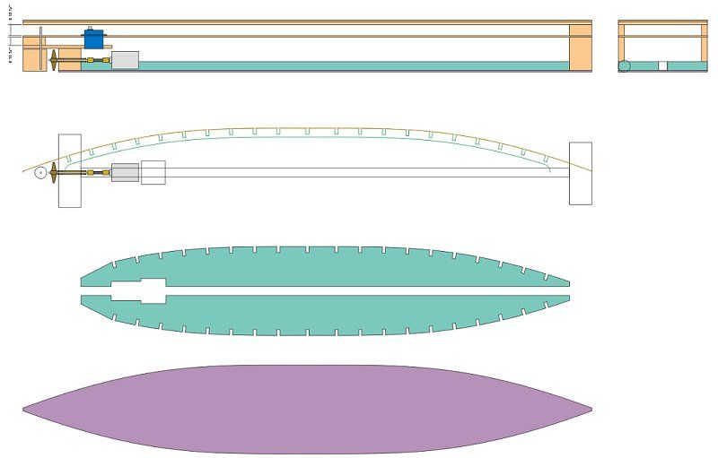

    This is a proposed Steampunk type 3 hull (armoured cruiser). Length is 48" with a beam of 7.5". As drawn, she has 2" solid on each end with twenty one 1/4" ribs spaced on 2" intervals. This leaves a little over 80% open area which is 5% less than other formats allow. What's everybody's thoughts on the spacing? My thought is that the 5% difference isn't all that much, especially as were talking ramming in the format.
  12. Tugboat
    I can't see it (Army firewall, drat them), but 5% ain't much to worry about, especially with the 1/96 scale. There's plenty of shootable area. I like 2" spacing, and a stringer on the waterline. Why? Because with us allowing ramming, a stringer and 2" spacing will make a ram something to try to avoid (being hit by), but not make it an instant end-of-game for anyone, because the build constrains the damage.
    Update, I can kind of see the pic on my phone. Is the brown area just in front of the prop beveled at all? A flat wall there will not give much thrust, but if it were to get a V-shaped bevel in the horizontal, that would be very helpful hydrodynamically speaking. Like from the outside of the hull down to the width of the stuffing tube.
    The stringer might want to move down a hair; it'll take a good bit of ballast to get that to be the waterline. I will have more commentary after I get home where I can see the scale numbers and view it on a bigger screen. But overall, I like the layout and shape. Maybe we'll see one soon!
  13. SteveT44
    Yes, it is fiared in front of the prop.
    As drawn the model is displacing almost 37 pounds. I can trim 3/4" off the bottom which will drop displacement by 8 pounds or so. Sound good? Also Tug, what's the dimensions of your pump?

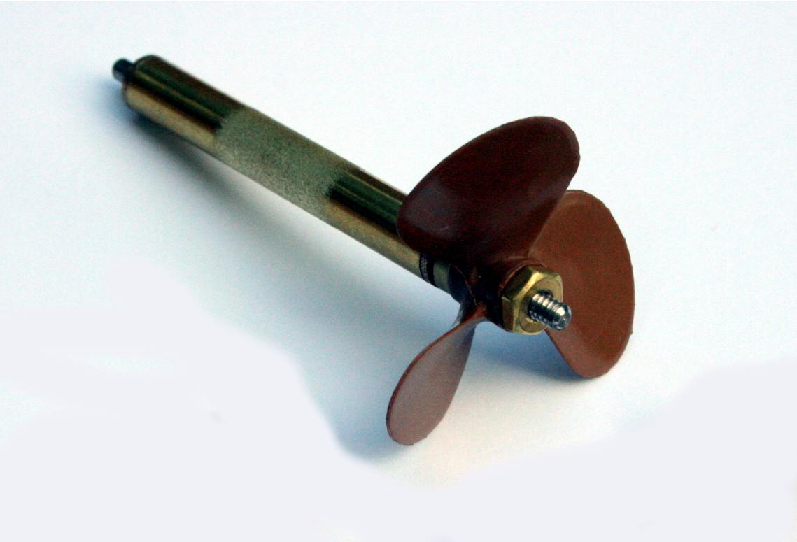

    I'm designing this around this $14 prop and shaft assembly from vac-u-boat.com. Anybody ever deal with Vacuboat? They seem to be big in the R/C tug community. This is a 1.75" prop. They also have a very cool coupling that looks better (and cheaper) than the Dumas.

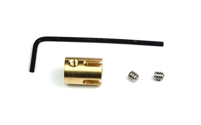

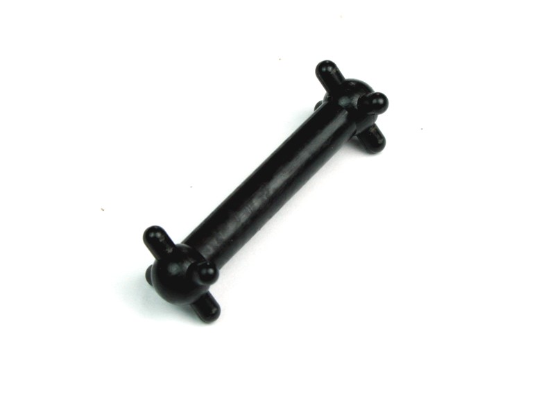

    I'd rather not shell out money for something I could print instead, especially a prop that can be damaged. But $14 for a stuffing tube/shaft/prop combo is not bad, and replacement props are only $4 each. I like the way their coupling looks (twice as many points of contact in the uni, very cool), but I'd probably cheap out and print one. Although $6.50 for such a fine-looking unit is pretty cheap. Hard to not be attracted to t3h shineez!

    What I like about the spec hull is that a few guys can get together on a weekend and do it production-line style, one guy cutting ribs, another cutting the subdecks and keelboards, and another taking the big pieces as they're finished, and notching them on a router table. Watch in horror as the vonTugboat tablesaw has a 1/8" kerf blade used to notch the ribs for the stringer! (clamp like 10 of them together and run them through... I would still put in 3 hollow-square sections in place of ribs, just to help keep the shape square. One in the middle, and one towards either end.
