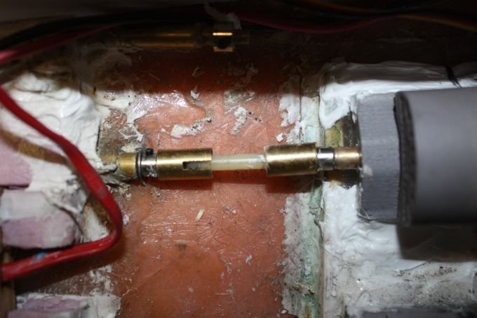

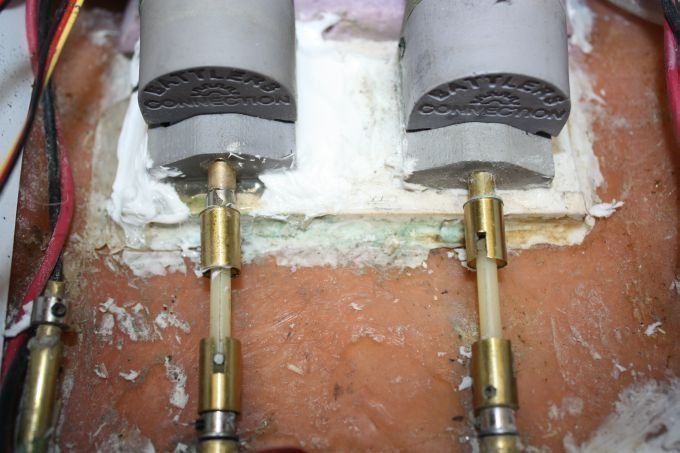

    The left shaft bearing is now lined up with the left stuffing tube.
  3. bb26
    What did you use to mount it to the hull?

    Hey Paul. This time I used AUTOMOTIVE GOOP. :)
