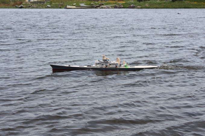

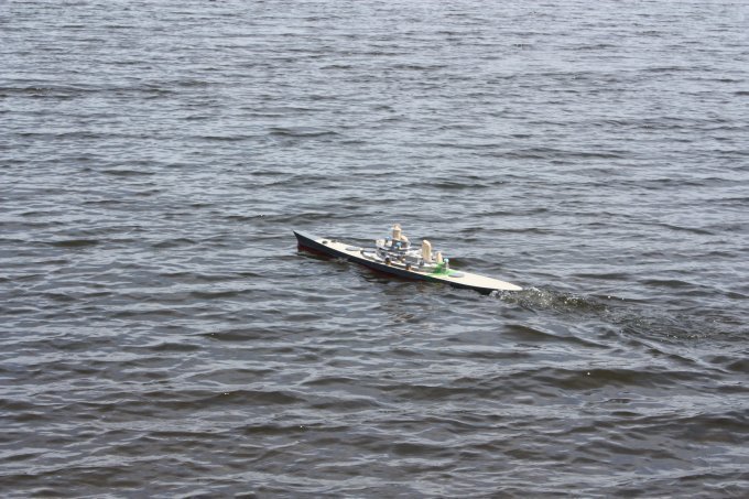

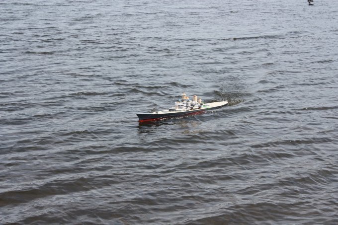

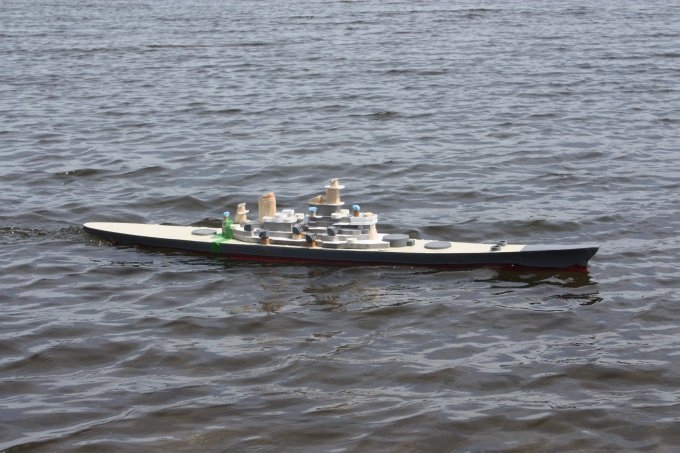

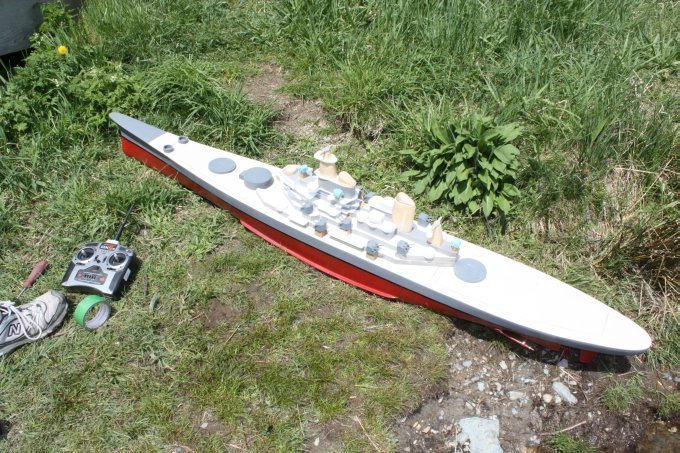

    Back from the Missouri's first shakedown on the water. Conditions were sunny skys, light to moderate wind. Sea state light to moderate chop. Winds were breezy at times which kicked up the swells inshore. I brought Roma along for rescue backup.
    I started the test with the float test . Just needed a slight amount of weight in the bow area but the model was on even keel from port to starboard. The first test the motors were activated but I had to reverse the servo for the Rudders. Once corrected Missouri started her run without the drag discs. As suspected the ran fast. I also had the rudders well off trim so I had no tools with me to correct it so I compensated by keeping the rudders neutral on the stick. The model was brought in and the second time it was launched with the drag discs. This time the model ran at speed . Maneuvering was very tight. The model plowed through the wave crests very well and though it rocked in the swells it immediatly righted itself. The rocking was minimal considering the conditions. Not enough water got in through the hatches to give the pump anything to pump out but little 4 inch dribbles from time to time. The model had no issue turning against swells and moderate breeze on the superstructure. After about 15 minutes heard a strange noise and the model slowed suddenly. Yep one of the drive gears let go. Surprisingly I was still able to cruise in on one shaft and maneuver even with the swells and wind. Passed it's disabled condtion. Found that the dogbone collar had let go and a screw popped from the pinion gear. Once back at the yard I switched out the collar and replaced the missing setscrews. This time the setscrews were threadlock in place.
    No issues with the TX or MAG Throttle system. Everything else went very smooth. Mo looked lean and sleek. Only systems left to install are the remaining servo and poppets, hoses, and the cannons themselves left. Won't be anytime soon for that but till then all is left is to finish the superstructure and deck cosmetics.

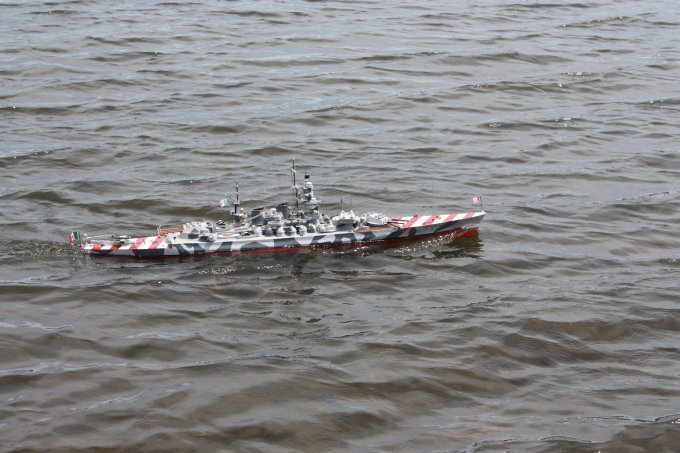

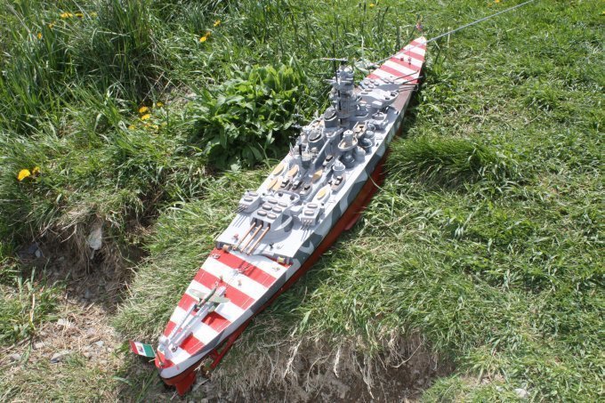

    Here she is ready to hit the water running.
    Coming in Hot.

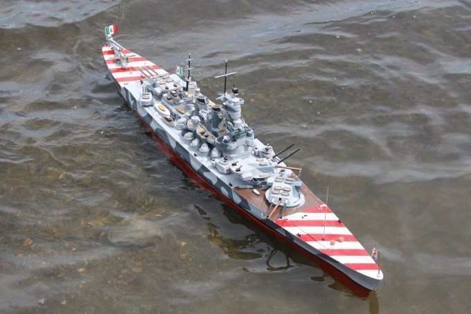

    Thats a really nice Roma model. Ever heard of a guy named Joe Vilar who had one in the early 90s? It was awesome looking too.
  13. bb26
    Very nice seeing the Roma back on the water.
    Thanks Ron. I don't recall that name back in the 90s but I remember seeing a very detailed Vittorio Veneto on one of the original Swampy Vids which this one had all 3 rudders working and 4 shafts. I was amazed at how maneuverable it was and how elegant the model looked. It hunted down a Brooklyn Cruiser. The Cruiser got away but barely.
