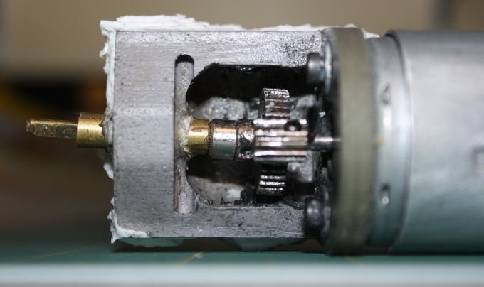

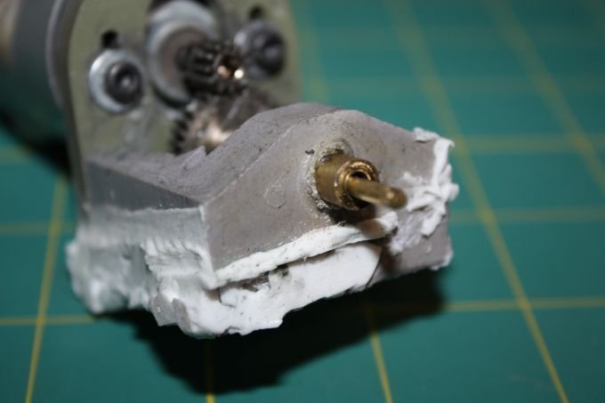

    I just came back from running the Missouri on her 3rd set of sea trials. The model ran well for about 10 minutes then I lost control of the port shaft again. This time though I was able to figure out what is going on. This time the pinion small gear and large gear were still attached to their shafts. However I noticed that the universal connection was on a not so straight line but a very bad off angle from center. I noticed that there was a build up of molded residue at the entrance of the outlet tube of the Gear box where the smaller connection shaft connects to the large pinion wheel and on exiting the molded gear box shaft tube it connects to the universal collar. I also felt the tube and noticed it was very hot. So looks like the small shaft was rubbing against the inside of the brass tube insert which created a lot of heat melting the interior diameter of the molded gear box and causing the tube to move and position at a very bad angle. It was so bad that both gears locked up. I saw that the connection angle was not quite straight as the right shaft and I am not surprised that heat built up there. I wasn't expecting so much heat to build up to cause a melt down of the box.
    So I removed the motor mount and will install another one but making sure that it stays lined up exactly with the prop shaft. I think when the mount was curing it moved a little. Good news the gears themselves are not destroyed. I stopped and coasted in just as I heard the shaft let go or stop. Has an unmistakenable sound to it when it's not running correctly.
    Other than that the speed was much better and the handling and turning circles were superb. So I feel good about that.
    You can see how the bearing shifted from the heat created by friction.
  11. CURT
    Looks like the melted vinyl oozed out around the bearing.
  13. CURT
    You can see how the angle of the bearing shifted. The gears locked up.

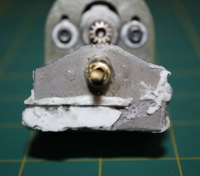

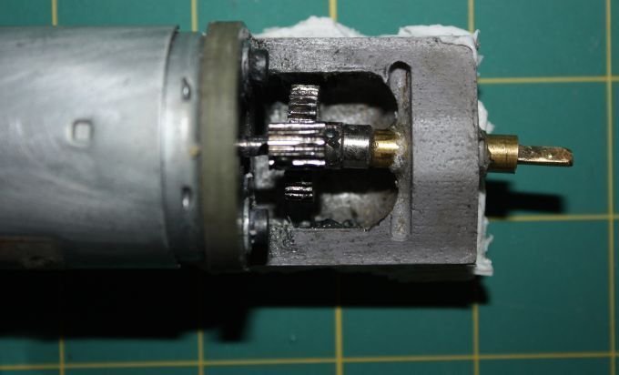

    Here are the pics of the motor mount with the bearing redone and with new large gear wheel. This time I took my time and Sean cleaned up the mini shaft that runs through the bearing and he soldered the bearing sleeves. Also I made sure that the alignment between the stuffing tube and the bearing in the motor mount were perfect. I used a high pressure bearing grease and coated the small bearing shaft and the gears. I checked on it this morning and the motor mount stayed put while it cured in position and gave the drive system a check. Much much better than what I had earlier. There is absolutly no play of the shaft within the bearing. Not only that both gears are revolving evenly with no wobble. I hada nub left on the end of the small drive shaft in the bearing which when it was in the dogbone collar it made it sit awkwardly. I had very little vibration and very little noise compared to what I had on the last 3 tries testing on the table.
    Here is some of the pics of the corrected version.
