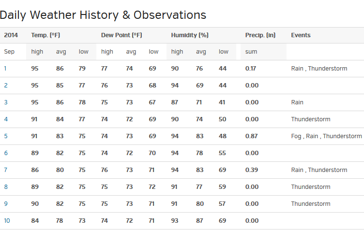

    I thought about it. The Florida heat index was so high that middle and high school sport teams cancelled practices outdoors several times over that last 10 days. When the heat is not an issue, rain with winds and lightning is. Outdoors is not a good place to work from May to October. Even the dope evaporates faster out of the can than one can apply it onto the balsa. Florida is a challenging place to do work outside. MMJR

  8. NickMyers
    man wouldn't have and couldn't have settled Florida if it was so inhospitable that you couldn't do 10 minutes of work outside on a regular basis for half the year
    work in the morning or evening when its marginally cooler and there is less oppressive sun
    failing that, if you simply must work inside, do as Greg said, and plunk down some coin for proper protective gear for you and your wife. I hope you're not subjecting any pets to chemical exposure while you're doing this.

    I got a little curious and so I did some looking.
    The following table is from WeatherUnderground's recorded numbers for Leesburg, Fl (which neighbors Astatula, correct?), from Sept 1 through today. [​IMG]
