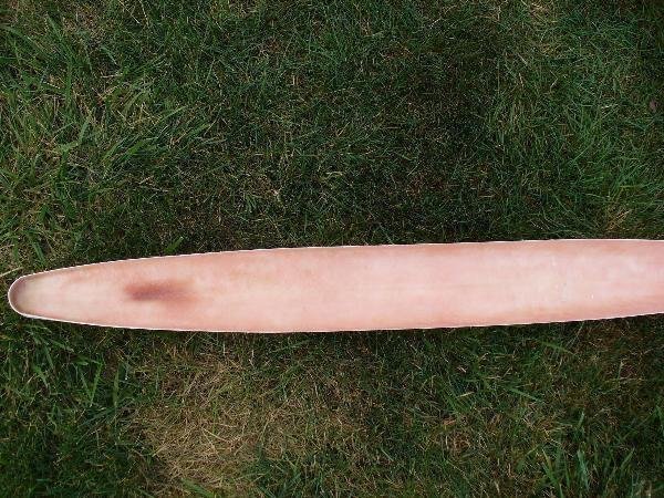

  12. Gettysburg114th
    I happened to be the LUCKY WINNER of the Agano hull at last weeks Treaty Conference. We had a number of hulls in the grab bag. Along with the hull I got a great set of plans in 1/144 scale that Eric Noble donated to the grab bag.
    Like Mike mentioned earlier the hull is great. I am going to work on it this fall and winter. I plan to use the Agano when I don't feel like dealing with sidemount damage. I also plan to work on a Japanese heavy hitter to play the sidemount game. I will set both ships up for Treaty and MWC action.
    Thanks Mike DeMarco for putting the hull in the grab bag and thanks to Eric Noble for the plans.

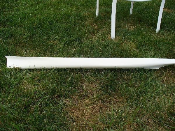

    Strike Models Agano hull. Very nice hull lines.

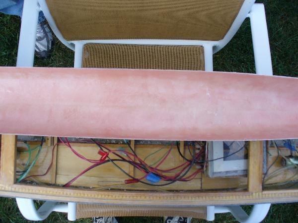

    Another view of the Strike Models Agano hull sitting on my Bismarck.

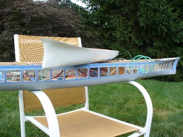

    Strike Models Agano hull sitting on my Bismarck. Showing the length vs the Bismarck.

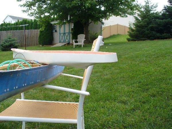

    Stern view of Strike Models Agano hull. Lots of stern to hide behind.

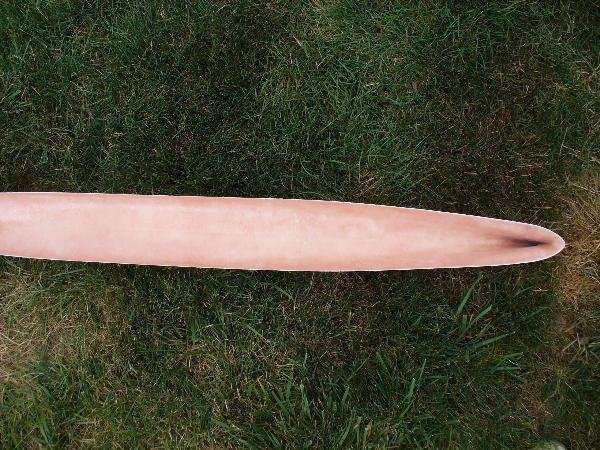

    Overhead view.
  19. Gettysburg114th
    Overhead view, forward.
  20. Gettysburg114th

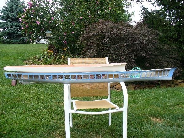

    Overhead view showing the difference in beam. Agano vs. Bismarck.
