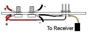

    What I've done in my watertight (Otterbox) boxes is to drill & tap #4-40 holes for higher-current connections, such as power & return. Then, install a screw from the inside out, with some silicone to help seal. Lugged wires connect via the screw.
    For low-current (i.e. servo) piercings, I drill a 3 * (however-many) matrix of small holes on 0.1" spacing, & install a solid header block in the holes. Solder wires onto the inside pins (all + & - can be wired together, which makes it a lot easier), then thread through the holes & stick with silicone. Inside, connect common + & - to the appropriate screws, run the 3rd (signal) lead to the receiver (single wire in a servo plug. Then, just plug servos/extensions directly into the pins on the outside of the box.
    I've gone over to waterproofing for later builds, but I've still got a couple of ships with waterproof boxes built this way. They work very well (i.e. never had a drop get in, or corroded wiring) & I haven't had any particular reason to refit anything.

  6. Bob
    Putting screws in your box like this leads to fires. I've seen 3 of them because of this. Some bb or screw or nut or some other random chunk of metal shorts out the screws. Also the ring connectors will corode and put resistance into your circuit, waisting power.
    The boxes where always water tight though, even after the fire was put out.

    681
    Wrong. There's nothing inherent about drilling & tapping through a box that leads directly to fires. Any fires you've seen haven't been because of terminals through the box; they've been because the job was done poorly. I've never had a fire (at least, not from the cause suggested). Maybe it's because I space things well-enough apart so that there wasn't room for a bearing to lodge between & short them. I also try to keep loose screws, nuts, etc. bouncing around in the hull to a minimum. Even if it were a real issue, it could be countered pretty easily with an insulating cover over the "hot" terminals, like what you can see on the battery cables of just about any car these days. Worst case, paint some ScotchKote over it/them after securing if you feel that it's necessary to have loose hardware laying around in the hull.
    I've never had a corrosion problem, either, but there's potential for that with or without a watertight box, with or without drilled/tapped holes. It's also pretty easy to keep in check with reasonable maintenance, too, at about the same level as it takes to keep waterproofed electronics ship-shape. That's still a heck of a lot less than what could be expected from corrosion in the wire itself. I figure it works out about the same, either way, as far as maintenance goes. The biggest downside I've seen to using Otterboxes is that they don't come in the exact sizes I need.
