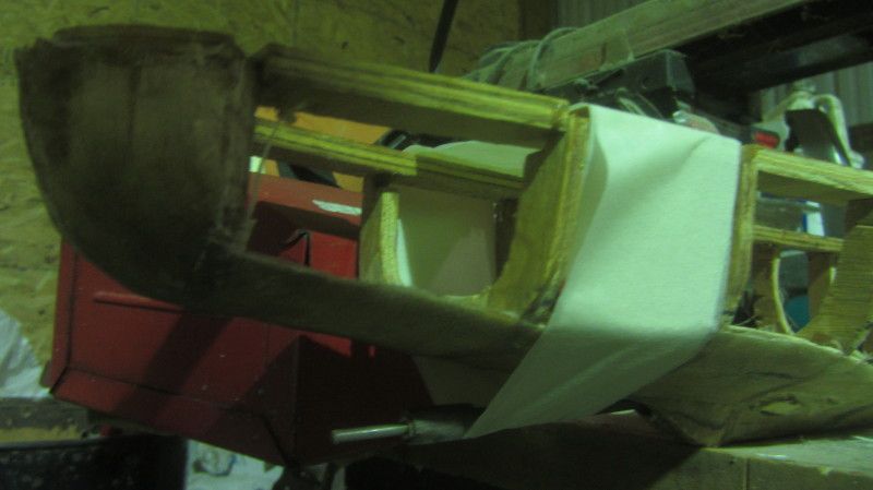

    So today I stumbled out to the barn to install the stuffing tube and take some well needed photos of Suffren. Everything went well, nothing broke or gave me any trouble. ( really rare) :)
    On with the photos....
    I added a little fiberglass cloth to help hold the tube in.
    Taped the stern so nothing would move.
    Epoxy is in!
    Extra epoxy went into the water channeling to help waterproof it.
    Here is the fix. Nothing pretty, but who says it has to be....:rolleyes:
    So there you go.:)

  11. NickMyers
    Is this the final angle of your propshaft?
  12. Beaver
    It is now....:) It's really not as angled as the photo shows it to be. I'll take a photo today, but I'd say it's only a degree or two off center.
    When I first drilled the hole, I drilled it as level as possible. This is where I ended up.
    Beaver
  13. Beaver
    Here is the photo. I don't think the angle is too bad.
    Beaver
  14. Tugboat
    That's not bad at all.
