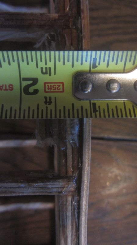

    In the midst of checking everything to make sure it was within the rules I noticed this.
    That is the subdeck/cap-rail where I cut the subdeck and glued it back together. The width is about a 1/16 over 3/8". Is this something I should worry about? Should I sand it down to required width?

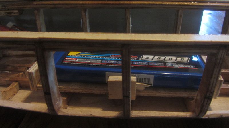

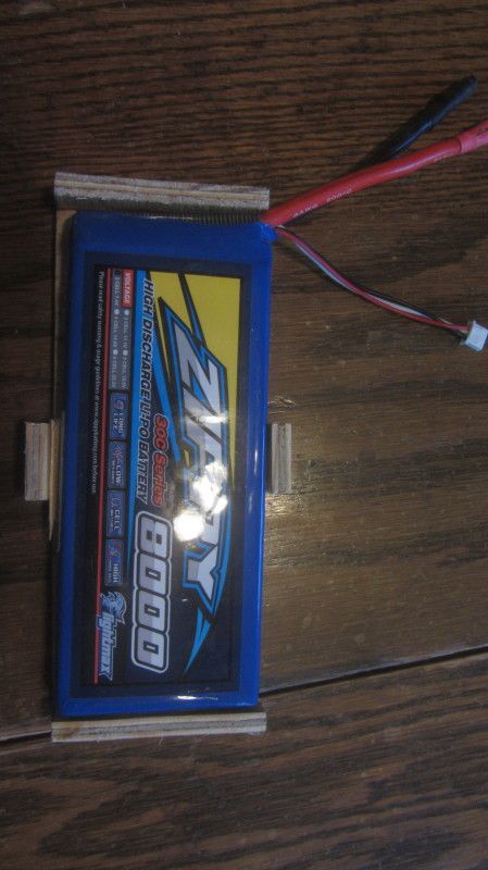

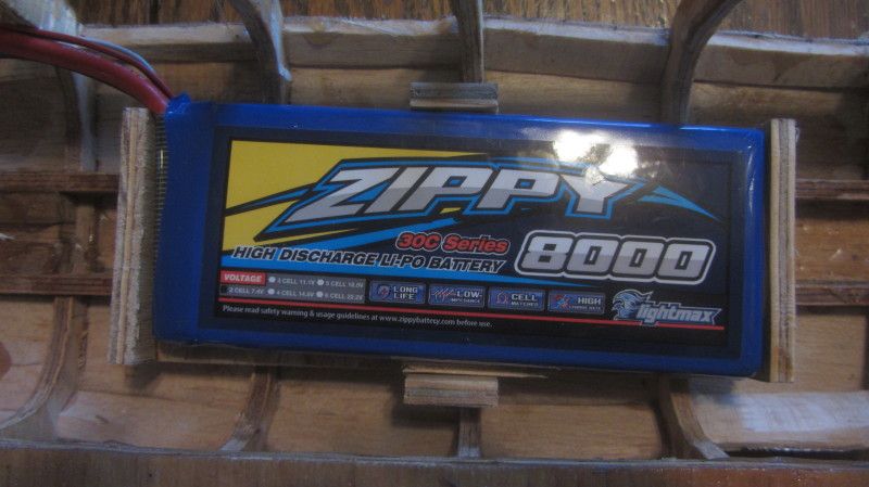

    I also got to make a battery bracket that I hope should work.
    Should the bracket sit above the ribs to allow water flow to the WC?

  15. NickMyers
    Water should flow yes
    sand your repair job down in a beveled manner such that the outside edge is the 3/8" required

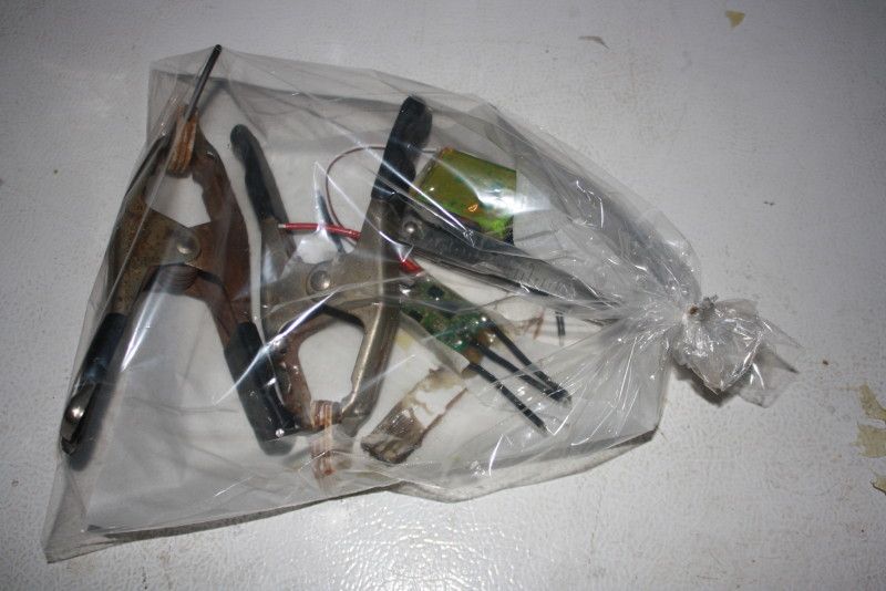

    Put the last coat of epoxy on the ESC's tonight. Also used the extra epoxy to glue the rudders together.
    Before I did this I had a little problem. I had no heated workspace except the house, and I can't do anything in there because the epoxy stinks. So I came up with an idea that would allow me to leave the stuff in the house to cure. Solution, plastic bag. :) I put the epoxy on, stuffed everything into the bag, sealed it, and everything goes into the house to cure. :D
    Reminds me of that saying, "necessity is the mother of invention." :)
  20. Beaver
    Photo of the curing "bag".
    I have a piece of wax paper on the bottom of the bag. In the back I have two clamps holding the two rudders together as the dry. The ESC the the one clamp looks to be leaning on is the pump ESC. The other one is the drive ESC being held up-side-down up by a pair of pliers. :)
