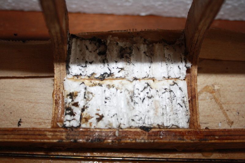

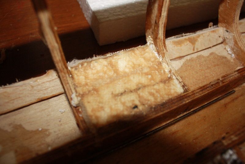

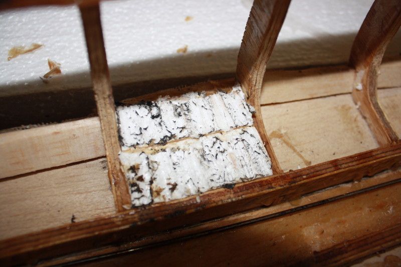

  14. Beaver
    Ok, so here are some photos of what I got done. It isn't much, but a lot of it was experimenting.
    Even though I said that I didn't want to use foam, I ended using it anyway. After gluing the foam in, I used a hot rod to cut it flush with the 1" below the Wl and the water channel. To make it nice and smooth I laid a layer of tough, fibrous material and saturated it with Tite-Bond.
    Another view.
    With the Tite-Bond coating.
    Do you guys think this will be OK for the rest of the ship?
  15. Hovey
    Hovey Admiral (Supporter)
    323
    Washington
    I wouldn't recommend Titebond as a sealer. First, it isnt meant to be one and using a product for uses it REALLY isn't designed tends to lead to problems. Second, water will get between the glue and the wood of your hull if you do it that way, so you really should seal the wooden hull before layering foam and what not on top.
    Personally I like concrete sealer but would just lay it on top of foam as I like the self leveling/non-skid surface and a thin coat doesn't weigh very much.
