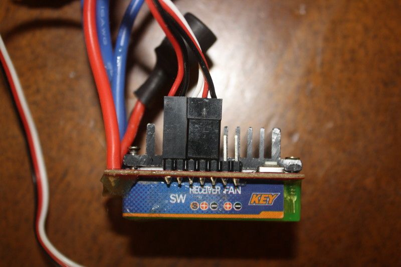

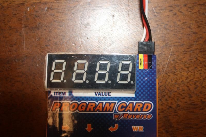

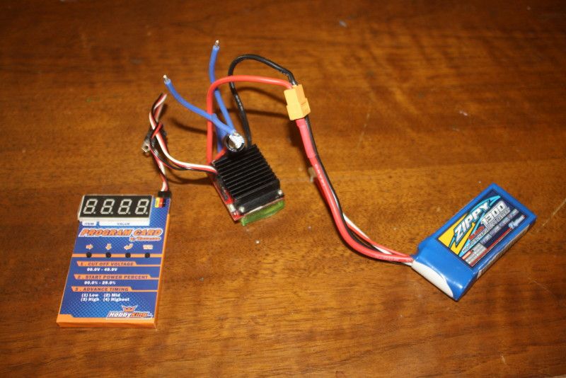

    Here are some photos of my setup.
    Here is the setup as a whole.
    Here is the switch and the wire going to the card.
    And here is the wire on the card.
  18. absolutek
    I would guess the ESC is probably bad then.

  20. NickMyers
    You should grab a multimeter and verify that the pins for the RX/Card connection are supposed to Be Signal (+) (-) and not (-) (+) Signal. The ESC case shows the first, but the manual shows the latter, one of the two has to be wrong, and im my experience with some of this stuff, its just as likely to be the ESC as the manual...
