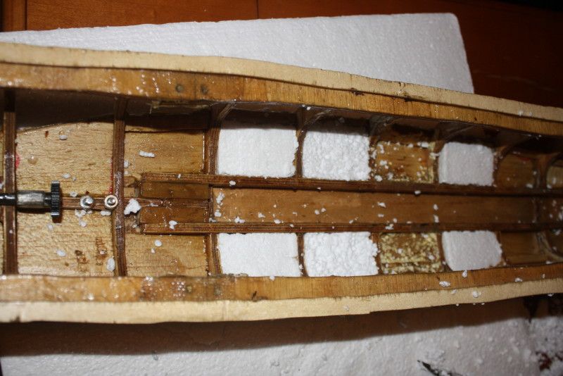

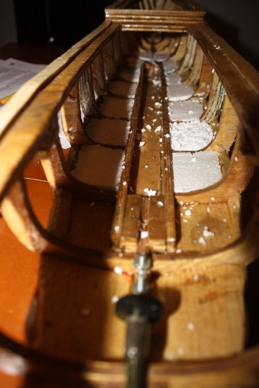

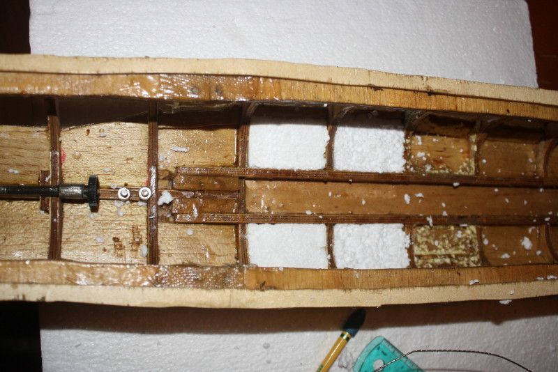

    I've been putting foam into the ribs the last few days, and all that remains is the stern area. I'm not sure what the best way to word this question is, but here goes.
    Where the stern curves up to make room for the prop and rudders, the rib bottoms are at different levels of height. What is the best way to fill this area in so that the water will drain to the pump? Should it be like steps from rib to rib with a slight downward angle, or should it be like a slide straight to the bottom, or nothing at all?
    Does that make any sense? :)
    Here are some photos of my progress so far.

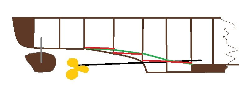

    I just finished gluing in 2/3 of the foam. Just the stern is left, which is where I need to ask a question.
    For the past few days I've been trying to figure out how I should lay foam in the stern.
    The red and green lines represent the top of the foam. The green example just slopes from rib to rib right down to the WC, whereas the red one is like steps from rib to rib down to the WC. Which would be the best option?
