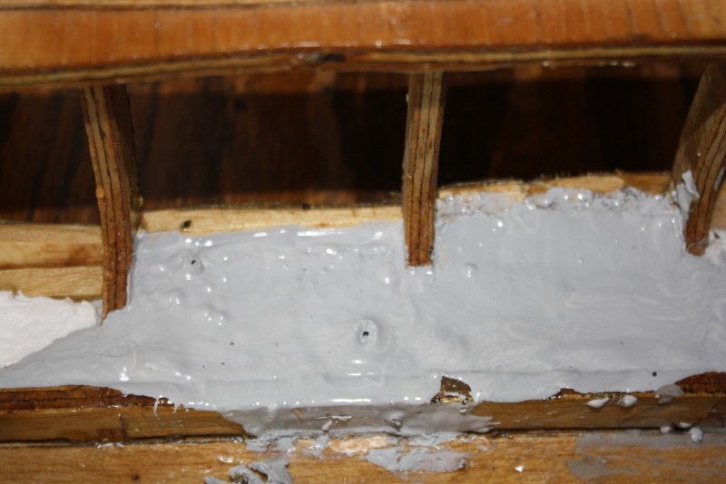

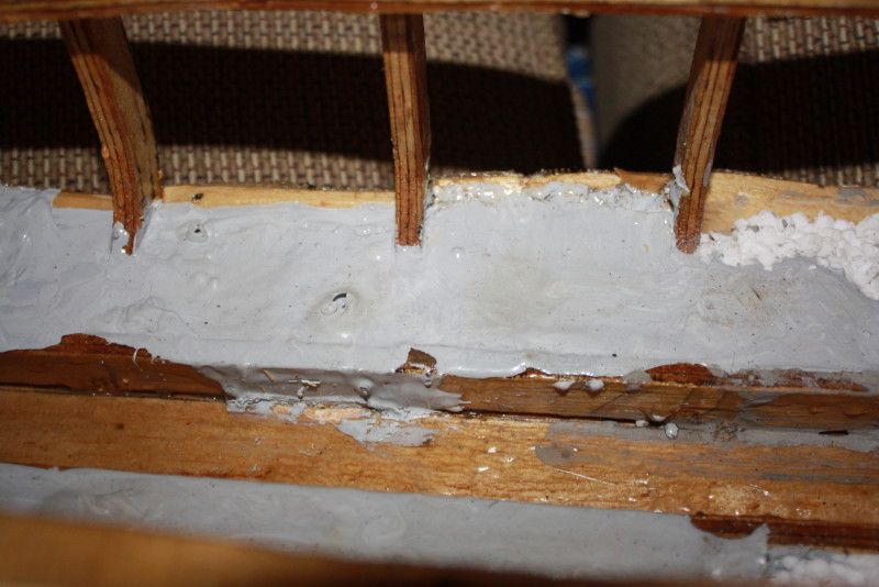

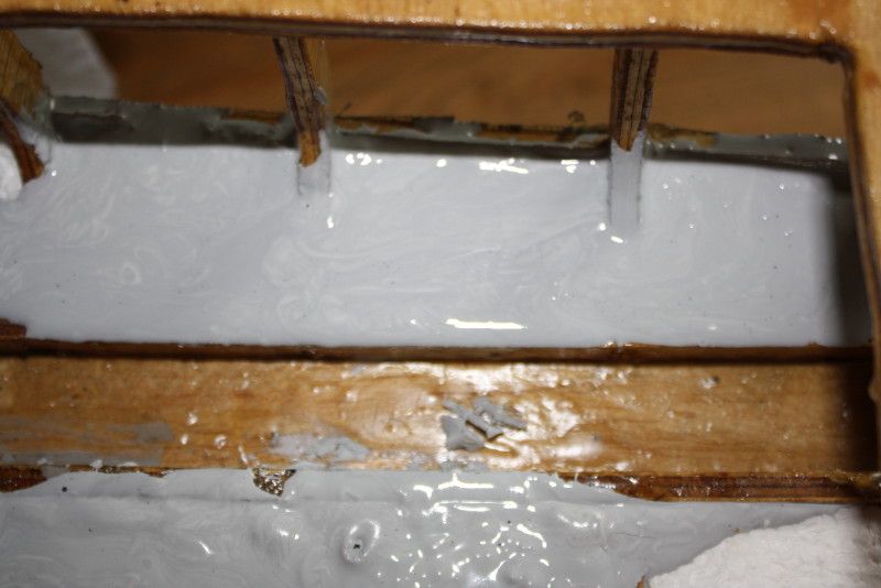

    First pour last night was a disaster. Take a look at it.
    I guess I'll have to put another layer over that when it's cured and hope it turns out better. :)
    Anyway, I decided to fill in two more ribs on the opposite side.
    You'll notice that there are actually three ribs filled in. That's what happens when somebody pumps too fast. :rolleyes:
    After that I was getting a little sealer happy, and filled in the whole front of the ship. :)
    Hoping it all cures nice, otherwise I'm going to have to use my teeth to get it out. ;)

    Not sure what happened to that first section but the later shots are typical of my results. Looks like some serious air bubbles came up?

    Well looks like you need to cut a smaller hole next time and maybe get some time in on a caulk gun before using those tubes. I would have just filled the pockets and let it fill up to the wood or at least that is how I have been doing it. There is always next time and learning is key to anything. Remember if it starts coming out to fast pull back on the handle for the plug to relieve pressure on the contents inside the tube.
  12. Beaver
    Thanks for the comments. I believe what happened is that I was using the tip of the tube to push the sealer into the corners. When doing that I think it got lots of air entrapped underneath it which caused air bubbles to rise while it was curing, causing what is seen in the photos.

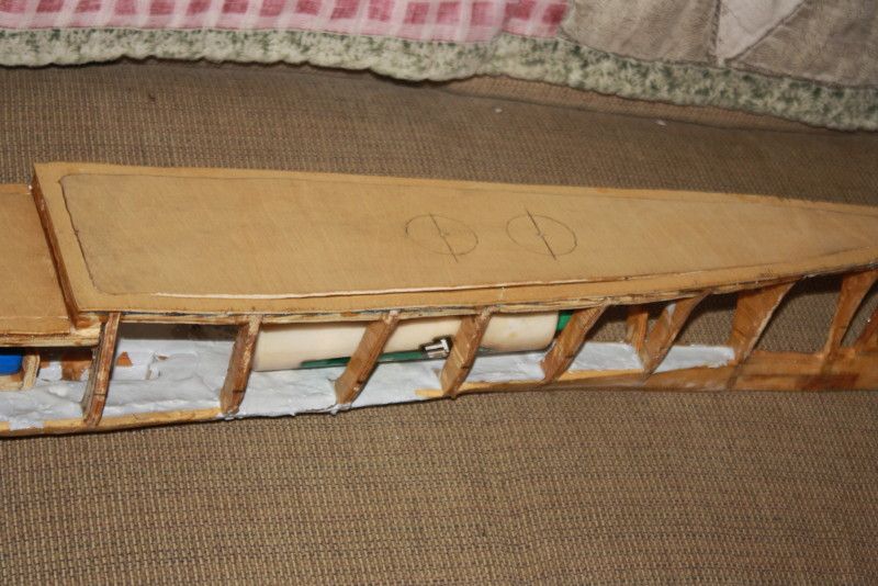

    Last night was occupied by marking the barbettes and building a servo holder. (Plus adding a much needed French accessory) :)
    So here is the overall ship. You can see the drive motor plus the battery in its approximate position. Also you can kind of see the servo holder in the stern. ( the twine taped on the bow was used to find the center of the ship for the barbettes)

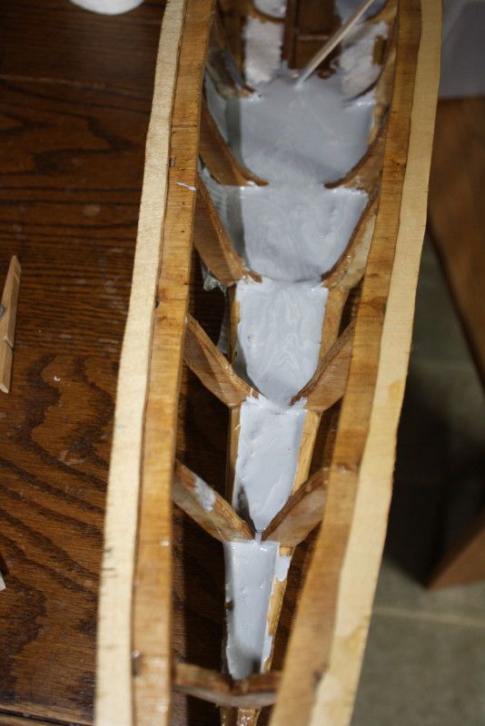

    Here is the first pouring of sealer. It's not as bad looking as it looked before. I think I'm going to put a thin layer over top of it to get a cleaner look.

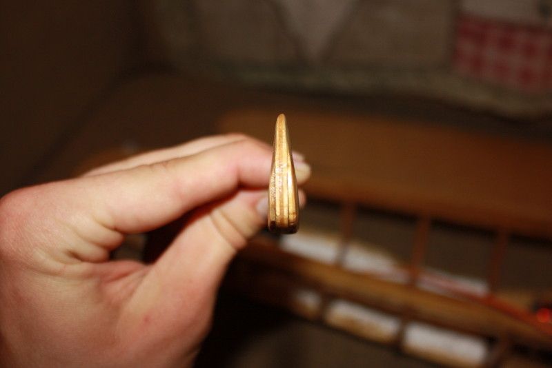

    Here is one of the rudders I made out of 1/8" ply. The spar varnish really brought out the grain.

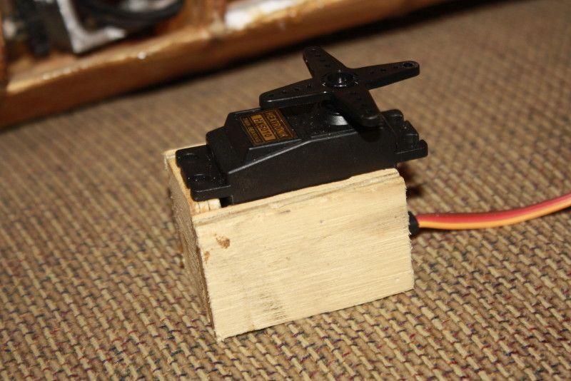

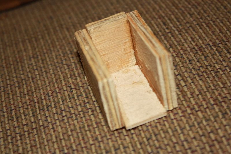

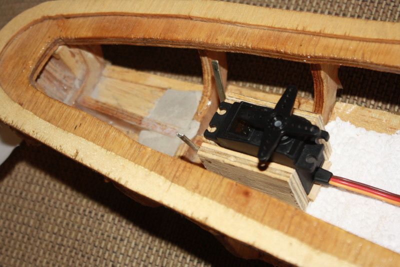

    Here is the servo box I made for the steerage servo. Those metal pins coming up are the ends of the cotter pin used for a strut.
    Here is an internal view. Yes, I know everything doesn't quite line up, but I'm keeping close to my motto, "Functionality IS King"
    Servo sits pretty nice in there.

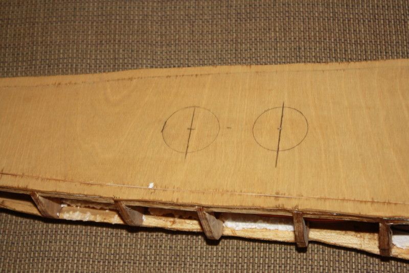

    Ok, so getting on to what this post is about. The barbettes.
    I'm soon going to be ordering a Co2 bottle and regulator plus two guns from BC. Is there anything I should know before I order?
