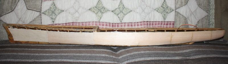

    Here are some pics of yesterday's progress. I've gotten from the deck step forward to the bow sheeted on the starboard side.
    The port side.

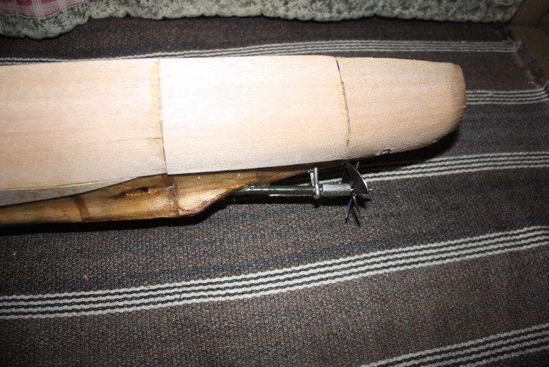

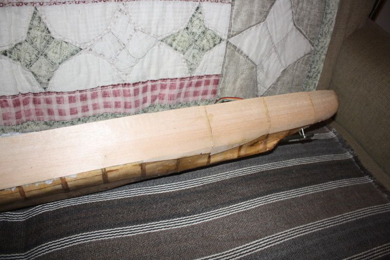

    The stern sheeting. It's rough bending balsa around those curves.

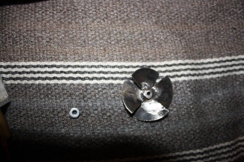

    The propeller I made. It has a nut welded to it and the shaft is threaded to accept the nut. It's stainless steel and 1 3/4 inches in diameter. Not sure of the pitch, don't know how to measure that. :)
    Here is the propeller mounted on the shaft.

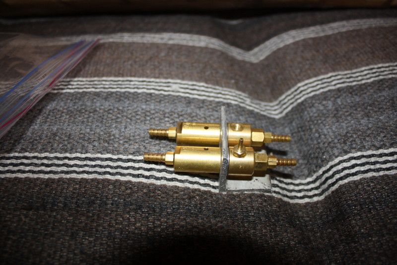

    I also took a piece of angle aluminum and drilled holes in it for the MAV-2's and MPA-3's.
  11. Tugboat
    Nice prop :) I like the valve mount, too. I did that before I had the 3D printer and they last effectively forever.

    I think the sheeting job looks great. Sterns are always problematic. An old trick was to pat down the outside of the sheet with a bit of white vinager. Helps make the bending easier. I haven't used that one in a long while so i'm not guarantying the process. Most everyone has a few spots to go over with CA to tack down after sheeting. I think you just need to tack down anything sticking up, sand & bevel the edges, put on the final silkspan if you haven't already, paint it, waterline it and the hull will be done.

    @Tug: Thanks! It took a few try to get that nut on the prop. After a couple different solders and then finally welding, it stayed on there. :)

    Now about that vinegar, I read that it makes sheeting easier because it breaks down the fibers in the balsa. In the same article, it said that when the vinegar breaks down the fibers it make the balsa brittle and bb's tend to blow out big chunks. Is that true?

    Like I said I have not used this in a lot of years. I'm not sure about the brittle part. When I re-did my Von Der Tann last week I used weldwood and using that seemed to give me plenty of flexibility to make the corner (the vdt stern is pretty tight). I did still have a couple areas that wanted to lift up but a little CA glue fixed that. I think keeping the panels in the stern fairly short 3-4" may help also. I'm glad your coming to Nats. Even if your boat isn't 100% there might be a spare boat lying about you can get your feet wet with.
