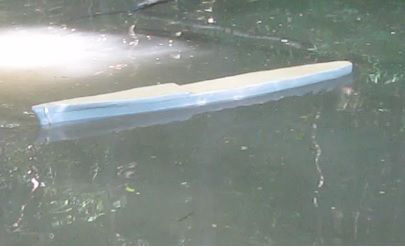

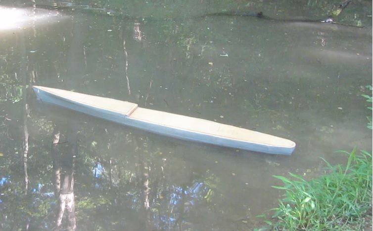

  4. Beaver
    Working on uploading some video right now. Here are some photos of her on the water. Sorry about the poor image quality, the photos were taken from the video. I forgot to tell my mom to take some photos as well as video. :)
  5. bgt0990
    bgt0990 Active Member
    Feb 3, 2014
    132
    Looks Good! Slap some guns on it. Carve out a mock superstructure from pink foam insulation and bring that puppy to battle. At our Spring Regionals Chris K forgot to bring his superstructure and spent the whole weekend with a flat piece of styrafoam to cover the inards. He was as dangerous as ever. As a last resort don't enable the guns or pump then slow it down and run the boat as the convoy ship FN Suffering.
