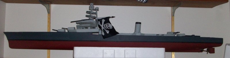

    So, do I just fill in where the hard area should be, and ignore the waterline even if the hard area is going to be higher than the WL.
    Thanks,
    Beaver
  2. NickMyers
    Sounds like you might be planning to float a bit high there.
    But yes, if it is legally hard by the 1" rule or 45deg rule, you can make it solid.
    Edit: if youre not sure, take some pictures, we'll be happy to help clarify.
  3. Beaver
    Does it look like I'm going to be a little high in the water?
    Here's my problem, the red lines are the waterline, the green ones are the hard area.
    So, what do you think?
    Beaver
  4. absolutek
    Looking at the plans, it looks about right.
  5. NickMyers
    Cant recall the weight offhand, but ran it for 2 years and the waterline was right for it.
  6. Beaver
    What is the height of the waterline from the ground? I have mine at 1 3/4".
    Thanks,
    Beaver
  7. NickMyers
    I don't have the ship anymore, and I've moved since, so I'm not sure if I have the waterline from deck or waterline from keel numbers. I'll tr to find some more reference shots and will shoot an email to the guy who has her, see if he'll grab a measurement.
  8. NickMyers
    Looking at pictures, I'd say mine sat about half inch down in the water from your marked waterline, so maybe 2 1/4 ? That said, having your initial waterline (and thus hard area) too low isn't a problem unless it causes sheeting issues. If you set the waterline too high though you may have to remove hard area later.

  10. jstod
    Were do the plans say it should be?
  11. Beaver
    These are the plans from the French site.
    Looking at this, it seems that mine is OK. Right know I'm kind of confused as to what I should do.
    Beaver
  12. jstod
    for the hard area use the water line on the plans. these ships tend to float at scale waterline anyways.
