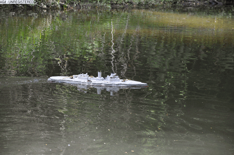

    Phill, I may have some trouble with your request for pictures of the Mogador on the move as it looks like most of the time you were on the move was in battle when I wasn't taking pictures, but I do have some of it in the water with the big boys, a few of its floating super structure pieces and one long shot of it on the bottom.

    On the plus side, the Mogodor had her combat debut. I think I should complain about 13 units against two... As Nick's picture showed, the result was wet but not because of battle damage but because she doesn't have enough battery and she got put under with prop wash. I will be looking at moving to NiMH batteries. I didn't go that way originally because I didn't have a charger that would charge them. That problem has been solved. Now I need some cells...
