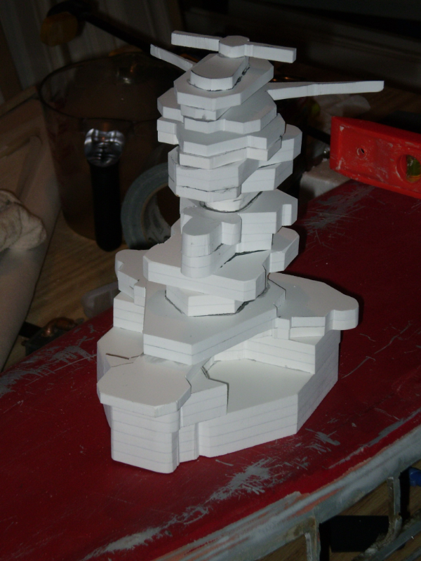

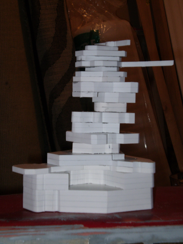

  12. Jay Jennings
    Have you ever tried making the Supstr. out of sentra (cintra?) don't know the actual spelling. It isn't as detailed up close, but it looks very good on the water and it is BB resistant (I didn't say BB proof due to Murphy' s Law).
    With a good set of plans you can do one up in a (full) day, depending on the size of course. I did ISE's final forward SS in 9 hours. That is tracing, cutting, sanding and glueing it together.
    It just needs a bit of a final sand, paint and a couple of secondary mounts and it's done.

    339
    I haven't really decided what to make it out of. Abdiel's superstructure is a mix of balsa block and styrene,the styrene is bb proof,although does leaves ding marks(could go with thicker styrene)and the balsa block is just painted. The ship is so tippy that I wanted as light as I could get,even if it means rebuilding the SS from time to time(lucky it's pretty simple)
    Now Little Rock on the other hand has quite a mass of superstructure and being a cruiser will tend to roll a bit so I need to keep it as light as possible. I was thinking of foam(like swampy used to make his SS kit's out of)but can't seem to locate any around here.
    Where can I purchase some of that cintra?(sp?)

  17. Jay Jennings
    Thanks guys, I appreciate the compliment.
    Scott,
    It can be purchased here in Burnside in Dartmouth. The sheets are 4x8 ft and cost around $60. One sheet will do allot of deck, ss etc. so if you can split a sheet with someone the cost obviously with drop.
    Curt, it weighs a couple of pounds now, but I plan to hollow a good bit of it out.
    To give credit were credit is due, I got the cintra superstructure idea from Steve Hill. On a bulkier ss, you can make a box type structure. Oh yeah, use PVC cement and a couple of clamps, it is set and strong within 30 minutes.
  18. Bob Pottle
    2,001
    Nice work Jay. How thick is that Cintra? Can you use styrene cement with it?
  19. HMCS
    HMCS Active Member
    339
    Thanks Jay, I'll have to buy a sheet and try it out.
  20. Chris Easterbrook
    Feb 13, 2008
    1,333
    Bob the Cintra most of us use is 1\4 inch thick, it is easy to work with and you only need a couple of tools to do what Jay and Steve have done.
