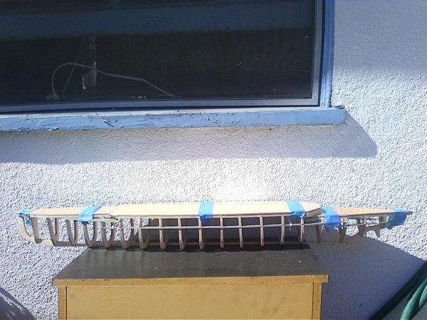

    Well if my attempts to post images works out I have some examples of the two superstructures I am either building or have built.
    I will start off with some Images of the Superstructure that is very basic I have my my Des Moines.
    This is a Frame work super structure. What I did for this was build a woeden box frame for each piece I needed and then added layers to each level I built. She is about 3 frames gluded and Epoxied toughter from from to rear and recently the back section did break off while Handeling it. You see a repaire being made where the blue electrial tape is on it. Ok a few Close ups of this Super are to follow.
    Here you can see where the thrid frame area is and the fact I had to glue it back to being one piece. For me this is temperory in the design. Also you can see one of the things I did to make the sides of the super a bit more BB proof. I added .98 thick ABS to the aises and epoxied them down and even coated epoxie over them to make it more BB proof.
    This is just an Overhead shot at the front end of the super. There used to be some smaller guns on this, but I have since got some nicer turrets for those and will be useing them once I have made the new Superstructure. I keept the inside of the whole thing hollow for weight savings and yes so the back of my gun Magazines can tuck up inside her.
