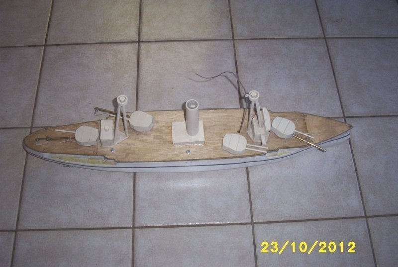

  17. ship crazy
    ship crazy Active Member
    Dec 1, 2009
    309
    [​IMG] I finished this one about a year ago, need to sea trial. Ship Crazy
