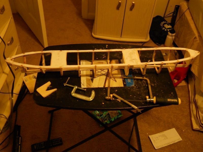

    So I started the construction of my first ship, a Liberty Ship, since I found the plans on here. I had the Ribs and Keel together and was getting ready to place the sub-deck, and I snapped the sub-deck in half, I thought I was building with bass wood, since I currently in C.T. finish an internship I didn’t have the tools to cut plywood.(only have x-acto knife). Come to find out I was working with balsa (I Have no clue how I didn’t notice) so I got a little t'ed and snapped everything so I am starting over with actual bass wood. Currently working on the ribs and keel. Sucks since its takes forever to cut anything out with the limited tools. I'll post pictures of what I had later.
  2. jstod
    Bass wood is going to take forever with and x-acto knife and your going to get frustrated. your better off just going to local hardware store and getting a cheap hand saw and some sand paper, cut roughly around the ribs and sand it down shouldn't cost you more then 10$-15$. just a thought.
    If you can get to a Lowes or Home Despot, you can buy a hand-held coping saw (sometimes called a jig saw), that will be a lot faster, as Jstod says. If you can spare the $5 on top of that, buy a c-clamp to clamp the wood to a table or counter, the cutting will go much faster.

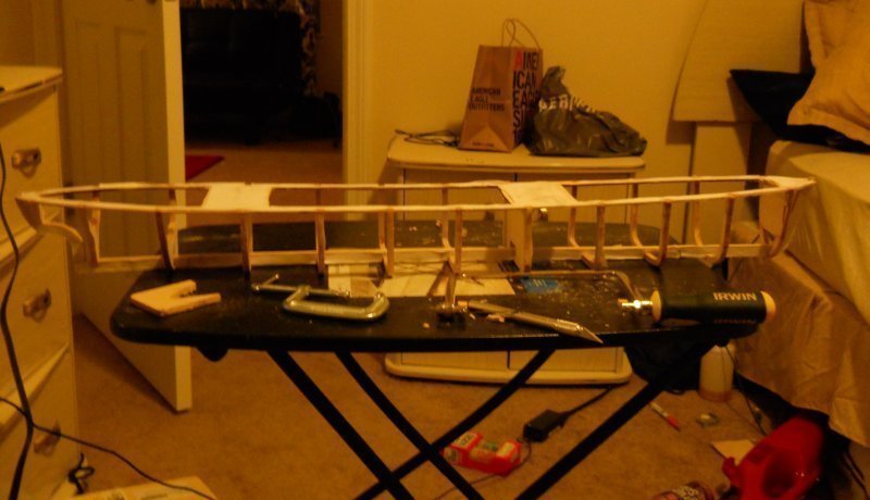

  10. Aggie9255
    Aggie9255 New Member
    Jul 13, 2012
    21

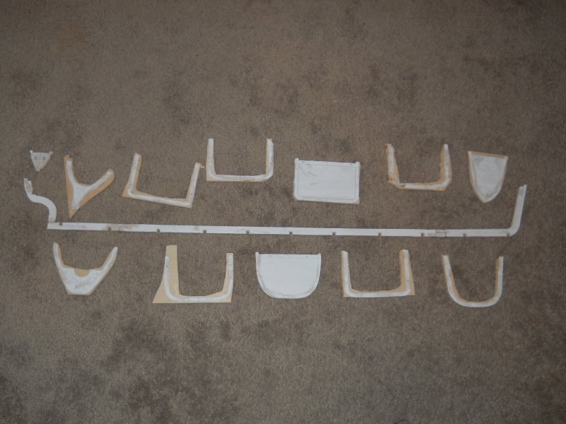

    SO this is where I am after the start over, gotta sand the ribs down but progress is so, with moving home, then having to move to where i have to for school which is next week. Have some sanding and cutting left on the ribs
    .[​IMG]
  11. jstod
    looking good. Keep it safe during travel last thing you want is to put all that work into it and have it break in transit

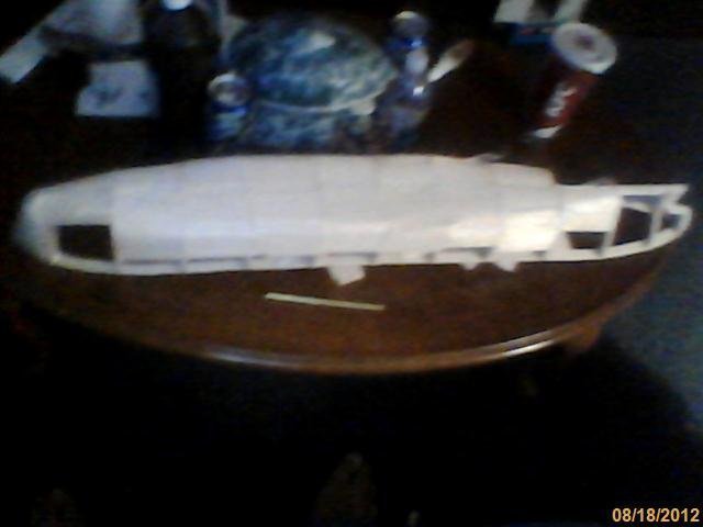

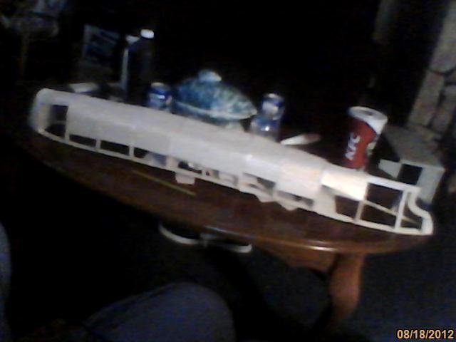

    well next is sheeting the bottom of the ship, making some progress[​IMG]

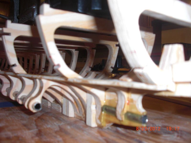

    So im almost done sheeting, the hull but I just got a thought on how I would put the stuffing tube in because the stern is so thin how should I drill the hole, or should i just cut out a piece.

    if the stuffing tube is as wide as the stern then just cut the piece out. thats what i would do

    Well i was just gonna drill it out starting with a small bit and working up to the right size. But as for as fiberglass cloth, and glassing the hull is better to do two layers or is one enough.

    For drilling, try mounting a copper tube into your drill - rough up the edges with a very small file or a dremel tool, and cut away. Nice clean and precise cutting without any chance of destroying anything at all. I recently bought some very tough and very thick aluminum tubing with a hole through it that goes inside the copper tubing I use for cutting my stuffing tubes. I'll epoxy a chunk into the brass tubing - the idea is so that the drill can grab the brass tube without crushing it, and the hole in the aluminum tube allows you to push out any wood that accumulates inside your copper tube cutter. I bored out these here using this method. Would never have worked with a normal drill bit, no matter how many sizes you use, especially since plywood is very brittle when you have such very small pieces like shown below. the stuffing tube sleeves are actually larger steel tubes - a 1/4" stuffing tube slides right in there. No way those are ever gona bend on me, and I can replace the stuffing tube easily if I ever need to. And it helped keep the whole stern assembly in place too, like a structural component!!!
