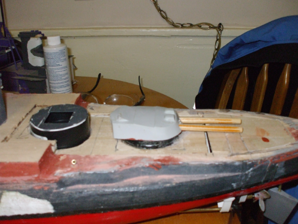

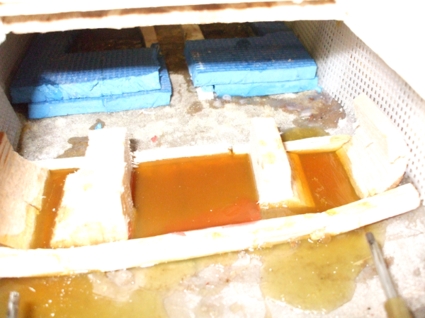

    well got some more work done today. Aft lower turret now has 2 dummy cannons in place and the whole thing is ready to be placed. I decided to go with dual aft cannons in the upper position. The engine mounts are all resined in and aint goin any where. The battery trays are resined. Cross members are in for all decks. The servo tray is in place and ready for the servo once it is tool dipped. Some minor trimmimg of the subdeck is need to allow for the rudder gears. Pics will be posted tomorrow.

    Wow Chuck if you canget some turrets and the two guns you need you will be ready very soon.
