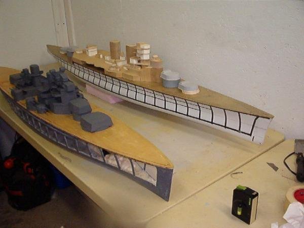

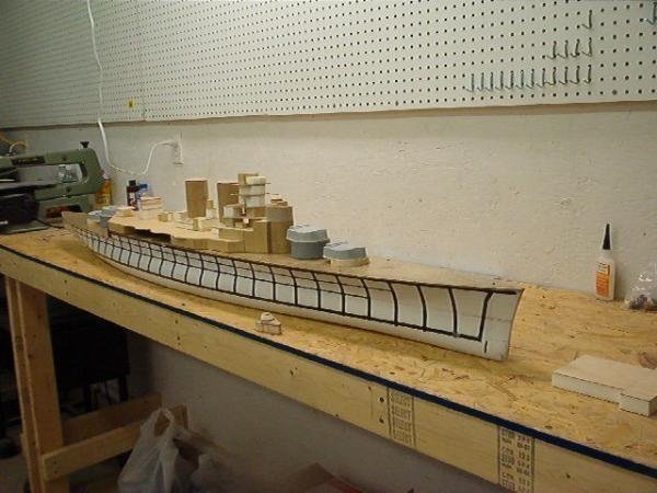

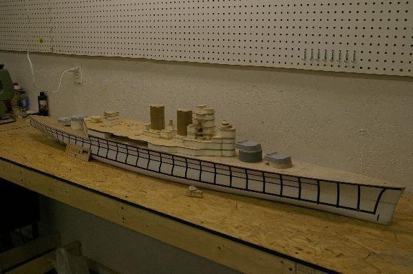

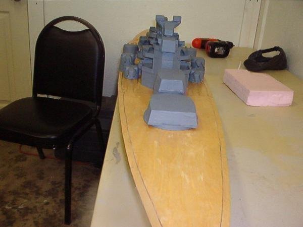

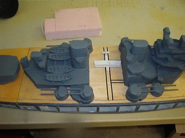

  10. froggyfrenchman
    Phil's new Prince of Wales.
    Hood's running mate for the Denmark Straits event.
  14. froggyfrenchman
  15. froggyfrenchman
  16. froggyfrenchman
  17. froggyfrenchman
    Hood and Prince of Wales.
    These two brand new ships will be taking part in our Denmark Straits event over the Memorial Day weekend in Xenia Ohio.
    We look forward to re-writing history, and the outcome of that historic battle.

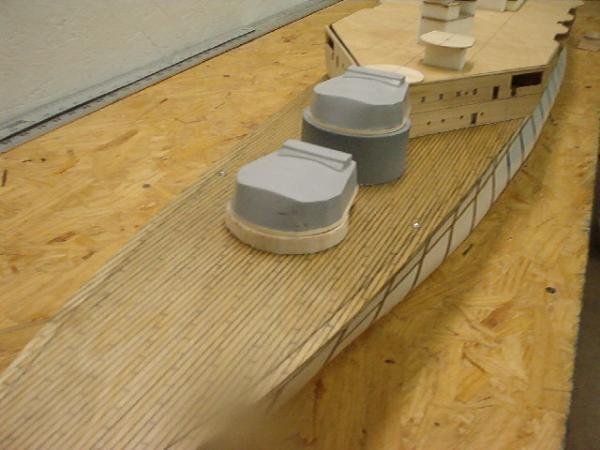

  19. froggyfrenchman
    Well.
    I went with the polyvar, and am happy with the texture. I put three coats on. I have to admit that I experienced a little discoloration in the wood though. Probably oil from my hands or something.
    Note to self.. Don't eat potato chips when working on scribed decking. Haha.

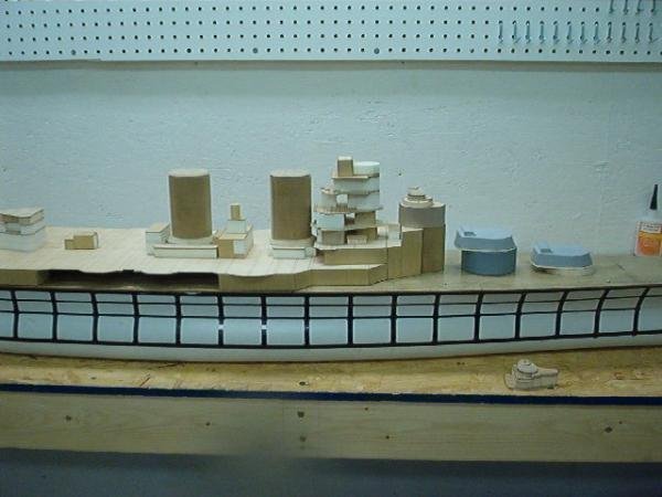

    I have about half of the water-channeling finished (the middle of the ship).
    I laid in some of the closed-cell foam (1/4" thick), and surrouded it with a 3/8" spruce walls. Then poured the self-leveling stuff over the foam, so it was only about 1/8" thick. It worked out well. The drying time was fairly short. That is the one thing most of the folks that I have talked to that used the concrete patch material said they didn't like about it. The thicker it is, the longer it takes to dry.
    The one thing that I forgot to do was to run some of my wiring under the patch material (in order to clean up the inside stuff. Oh well.
    More later.
