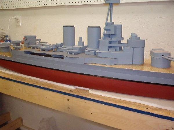

    Hey Mikey nice work there. I have a question..the Funnel bases. How do you make the platform at the base? I usually have trouble getting them right.I am referring to the sloped ring around the base of the funnel.
    I used 3/8" (7 ply) plywood.
    I traced the ovals for the inside and outside edges. Then cut the outside edge with a scroll saw, with the saw plate in the normal position.
    I then re-set the saw plate at the angle for the sides of the ring and cut them. I then cut the ends of the funnel ring as close to the desired angle as possible. Then I hit the ends with a sander to get them shaped. Then I cut out the center of the ring to keep the weight down.
    I like to used the nice plywood for stuff like that as you can hit it with a sander, and see where you need to sand to by looking at the different layers of the wood.
    Time consuming for sure. But the end result is nice looking.

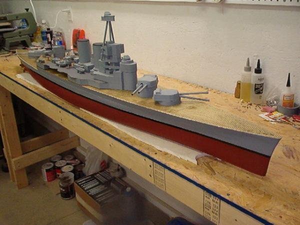

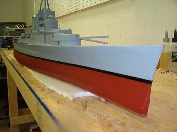

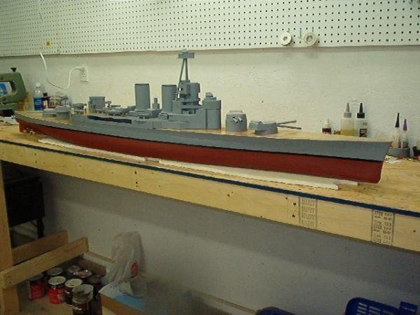

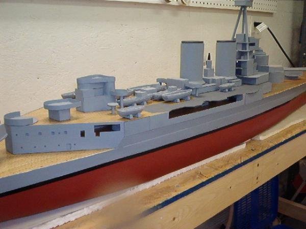

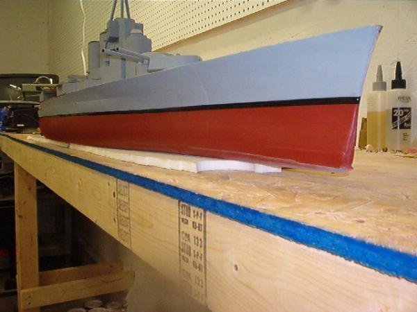

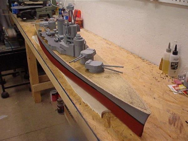

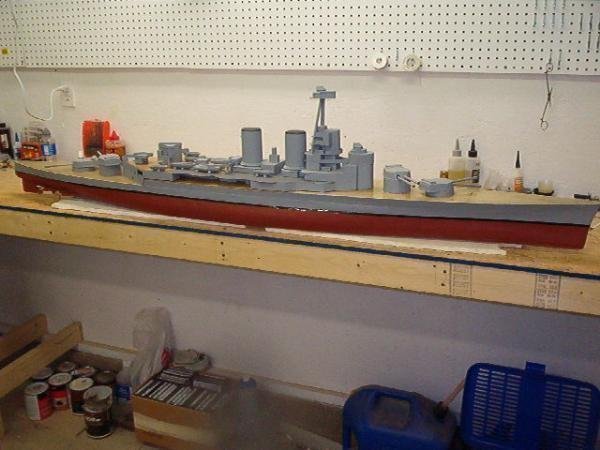

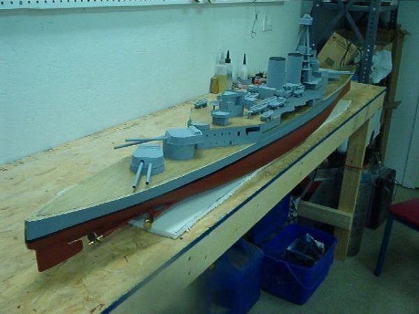

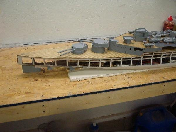

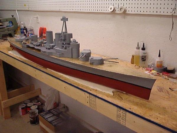

    They say a picture is worth a thousand words.
    Well, I have only had the time to post the pictures for the last few weeks. I will spend more time writing stuff up after Memorial Day.
  20. CURT
    Applause Applause Applause. Hood looks beautifull. Congratulations on your fine hard work.
