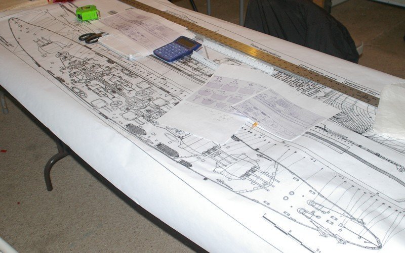

    The Lutzow sold to the Russians was a Prinz Eugen class heavy cruiser with two operational turrets installed (out of 4) with twin 8" guns. Not what is shown on your plan set, which appears to be similar to the triple 11" guns installed in the pocket battleships and Scharnhorst class. Planset turret is similar in faceting but wider than the 11", probably because the Russians had fantasies about installing 12" or larger guns which they couldn't produce at the time and were basing their designs off of German equipment. You may need to build a mold for the turret if you want to follow the plan set.

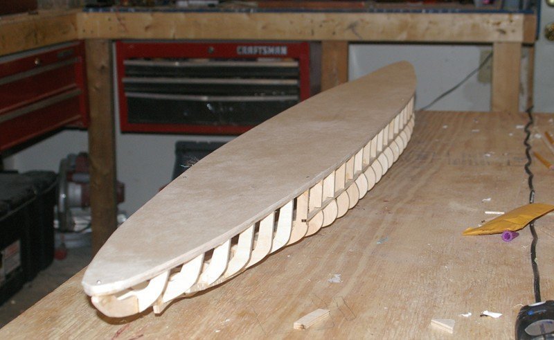

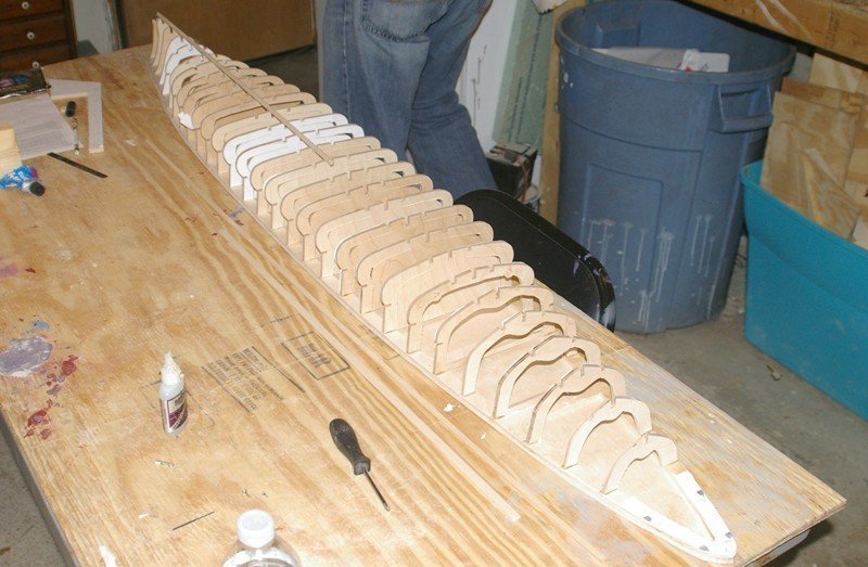

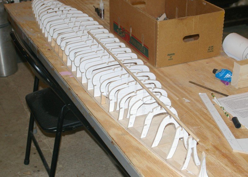

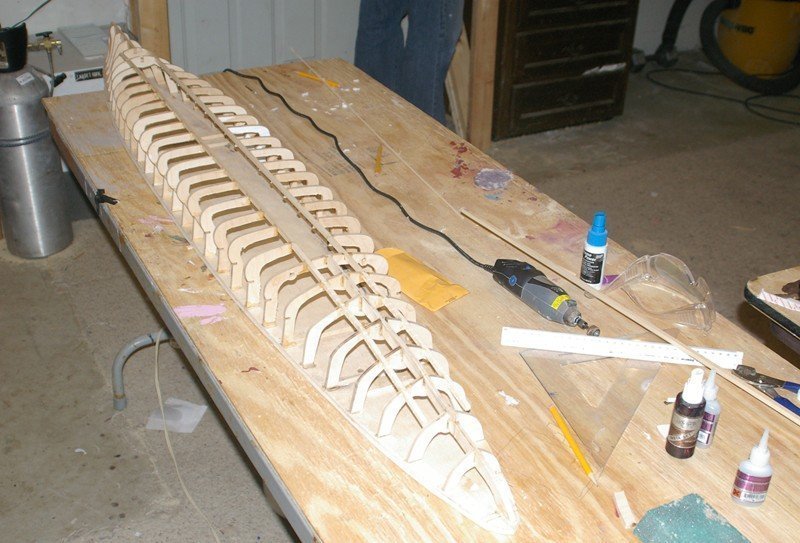

  15. rcengr

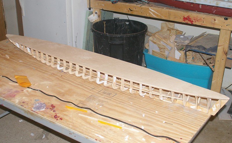

    I'm not sure if it is the pictures or if someone cut a little extra off, but the plans do show a deck that curves up at the bow.

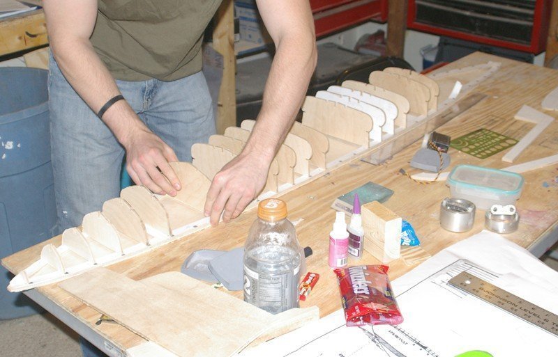

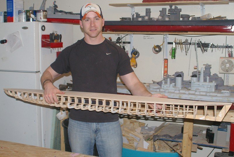

  16. froggyfrenchman
    The stern is flat. The bow is not attached yet as we were running out of time at the build.
    The last 12 inches or so still needs to be attached, and is having relief cuts installed.
  17. froggyfrenchman
  18. froggyfrenchman
  19. froggyfrenchman
    A very interesting ship indeed. I look forward to seeing it out on the water.
    Now we just need to build the big Russian.
    I have enjoyed working with the wood again.
    Thanks to all that are helping out.

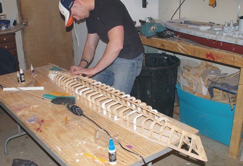

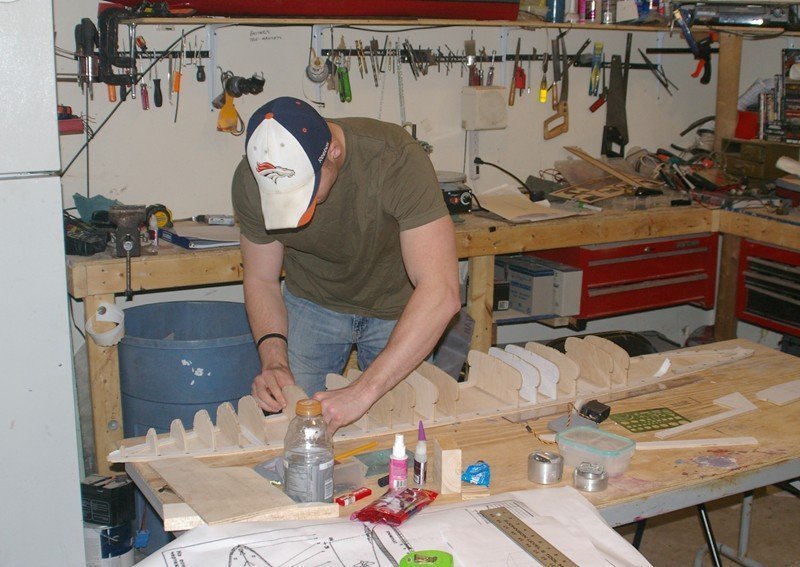

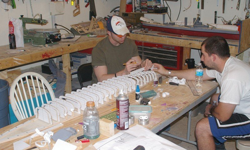

  20. Tugboat
    Is that a contractor working on your ship? He doesn't look Froggish!
    Boat is looking suh-WEET.
    Funny side note, your worktable on the wall there looks identical to the wall tables in my shop. And there's boats everywhere! Reminds me of home!
