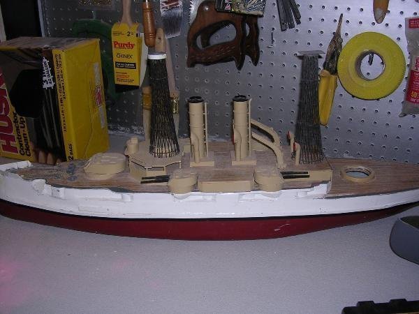

  15. Lou
    Ken,
    I built one out of brass, it was actually easy (did this for my mississippi).
    Get the profile shape from the plans. Now take a block of balsa and shape the profile on a drill or lathe. Use a piece of baswood and make disc's for the top an bottom. Make a number of corresponding notches in both.
    Here is the important part: On the bottom larger part, make it removable ( I used two dowels to attach it to the profile wood). Now take brass wire from home depot or lowes (used to hang pictures) and wrap from top to bottom in a criss cross pattern. Solder all the joints and cut the top off and the bottom where the wire is on the outside. Then remove the bottom disk and pull the form out of the cage.
    Wow, I think I am confused by that. I will see if I can send pictures.
    Lou
  16. Lou
    Ken,
    Look for my clevland build (page 13 or so) and check out the last page for the mississippi photos.

  18. Anachronus
    Where did you find the cowl vents?
  19. Lou
    Made them myself, found a how-to in a ship modeling book. Same with the turrets and guns
  20. Tugboat
