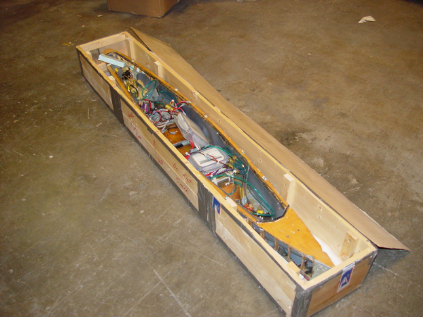

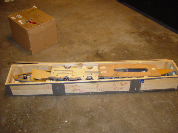

  4. jadfer
    I got her unboxed this afternoon but had to head out all night. I will work on her over the weekend. Rob checked the guns so she should be ready to go.
    I am going to put in power poles, deans ultra plugs, a power switch and test fire buttons then do a little housekeeping but dont plan any major changes right now.
    Here is the unpacking:
    I need to put the superstructure back together and then I will get some more pictures.

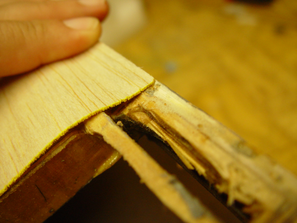

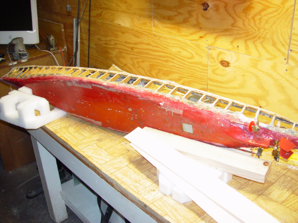

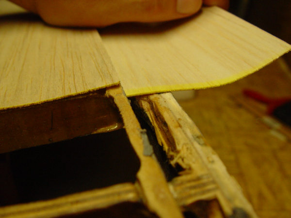

  13. jadfer
    Well I am ready to resheet the Tirpitz. I am not sure how to handle some things like the stringer but it looks fairly straight forward.
    This is the ship before I start.
    Here is one option. To use one sheet to cover it all. It leaves a bit of a gap but I just dont know what its supposed to look like.
    Here is the other option to use two sheets. I think this is the way it was done before.
    Any suggestions?
  14. Ragresen
    Ragresen Member
    Dec 29, 2007
    322
    It should be done like my Kron Prinz is getting done when IO sheet. the last picture is the method I am doing.

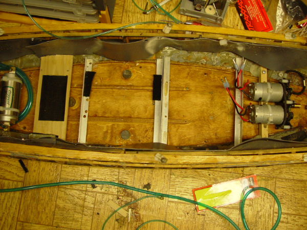

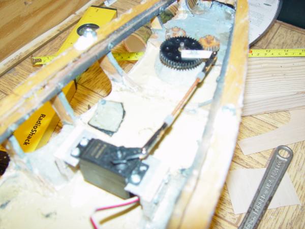

  18. jadfer

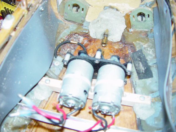

    Well I went to work on the ship and took things out to have a good look inside.
    I am in the process of changing out the connectors to make everything interchangeable and usable between ships.
    I was suprised to see the BC gearbox on the outside rudders. I suppose I could power them if I wanted to.
    No rudder box in the back so I will have to learn to waterproof servos.
    I like the amount of room I have compared to the baden.
    So I will add powerpoles for the batteries, change the solenoid to 16 guage color coded wires with deans 2 pin connectors, add noodle wire and deans ultra plugs to all motors and that should take care of the wiring.
    I get another update soon.
