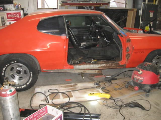

    Iceman, nice GTO. I use to have a 1968 firbird convertible, 350 4 speed. my high school budy bought it from me. I needed the money and he worked for the family buissness.
