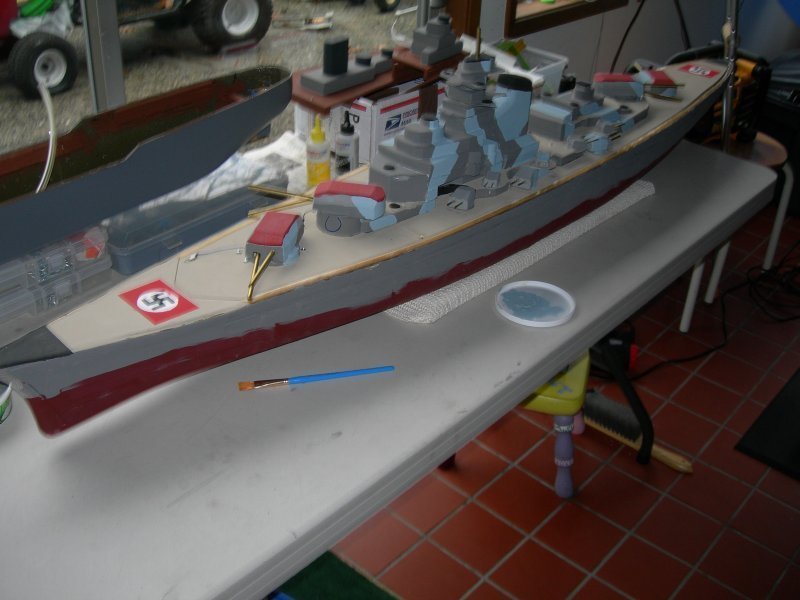

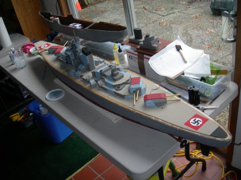

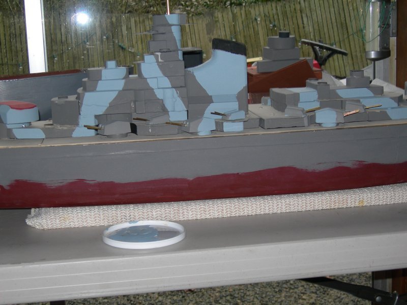

    new paint job
    .[​IMG]
    .[​IMG]
  14. NickMyers
    nice topside, me likey
  15. KeriMorgret
    Jul 15, 2009
    608
    Seattle, Washington
    Do we get to see her this weekend?

  17. joe thomer
    joe thomer Active Member
    Sep 25, 2010
    194
    saturday, we will be there
