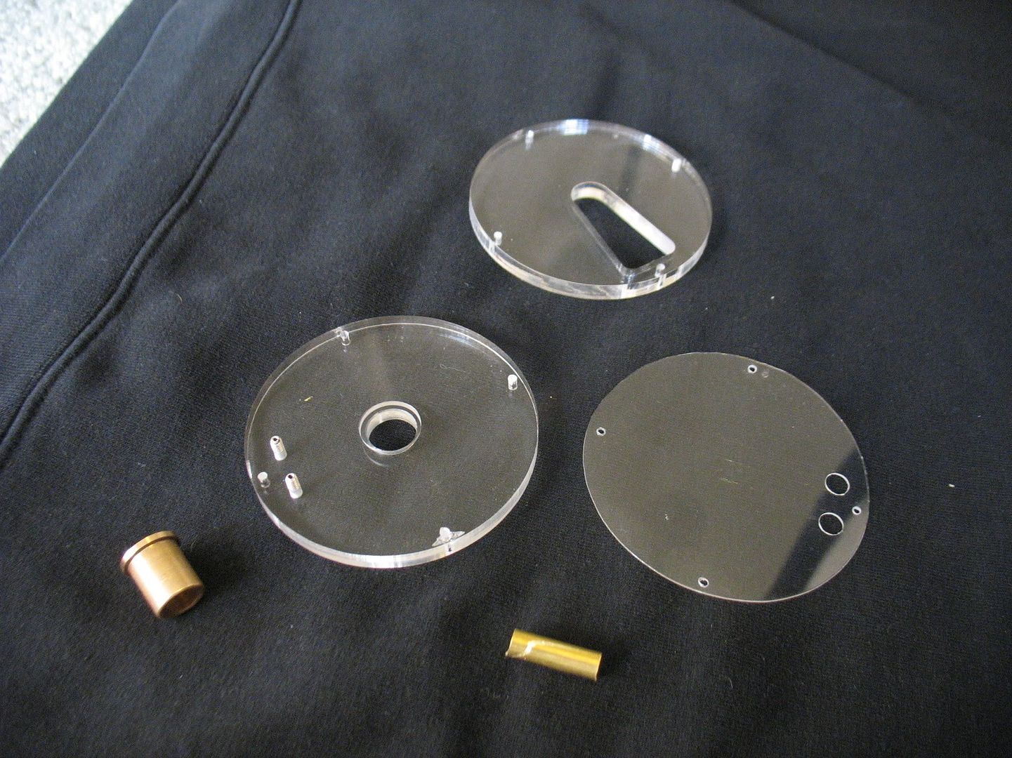

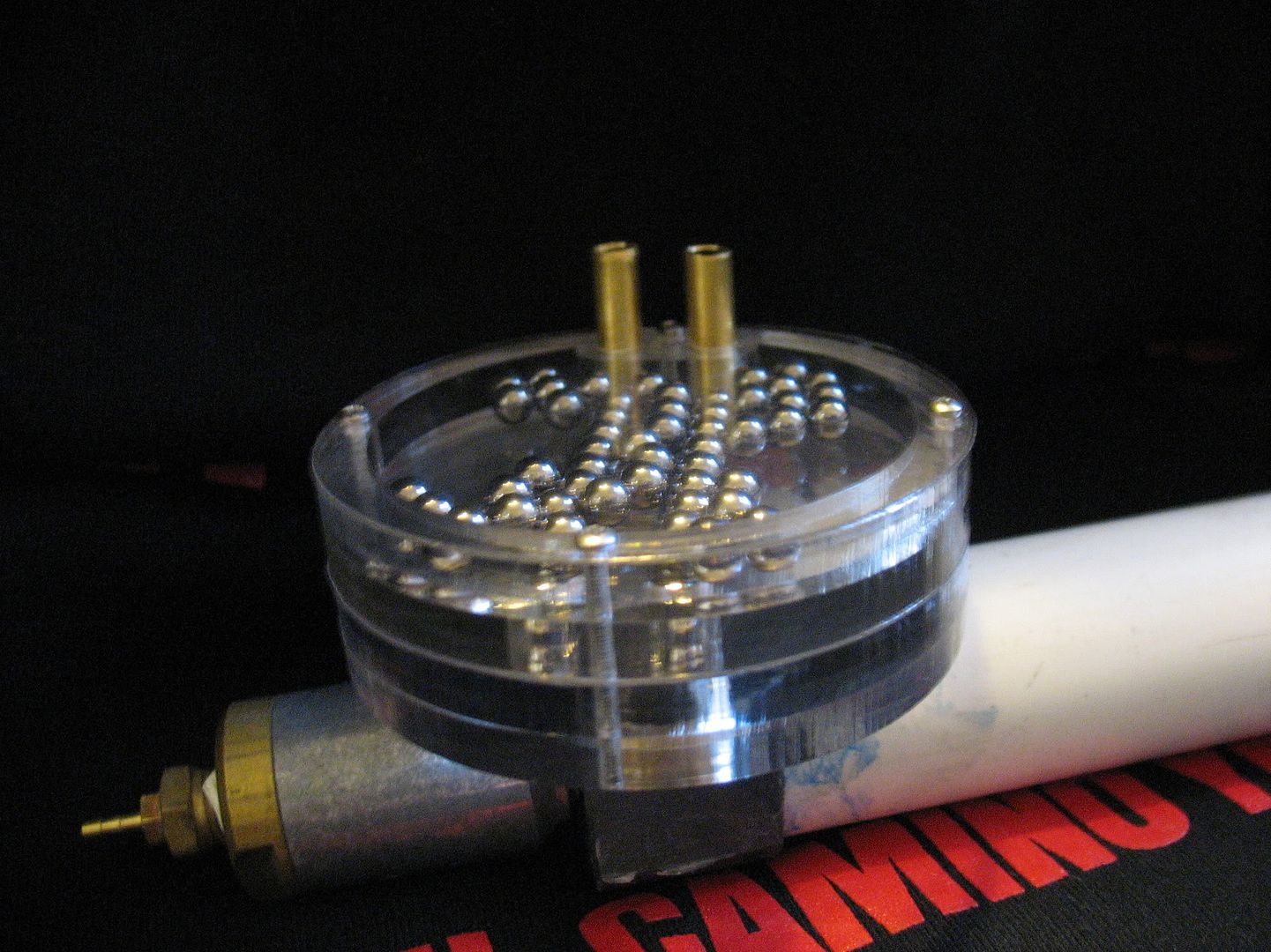

    Ah, OK I get it now. The diagram is for a .177" cannon, so the builder simply took a 1/8NPT to 1/8"ID air line fitting, and soldered a 3/16" ID brass tube over it. Very crude, but functional if you don't have good tools. An easier solution is to use a plumbing T fitting, with 1/8NPT male threads on the bottom and 1/4" compression fittings on the top and side. You can see an example of that here:
    Speaking of tools, what sort of tools do you have access to? I do not believe that the traditional Arizona cannon will work well for you, since Arizona cannons are single-barrel only and the Mogador has twin turrets. Plus you want rotation, so placing two Arizona cannons side-by-side simply will not suffice. If you have access to a decent lathe, you can make a really nice set of rotating cannons just like my laser-cut cannons, except in .177" caliber. You would need a lathe capable of grabbing up to a 1" diameter brass part, and a 1/8NPT tap and die.

  19. Kotori87
    In that case it is very simple. You can build your own breech using the same technique as the plans you have. You will just be using 1/4" ID brass tubing instead of 3/16" ID, and you will need to get 1/8NPT threads on the bottom somehow. You could build up layers of brass tubing then cut threads with a die, or you could chop off the threaded end of some 1/8"NPT fitting and solder that on. The specifics don't matter so long as it gets there in the end.
