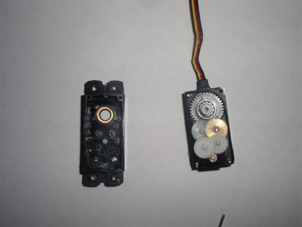

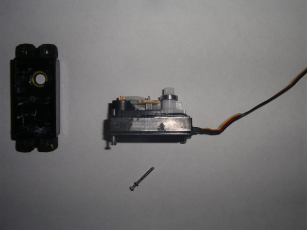

    Snipe, djranier, I am curious what sorts of waterproofing protection the Tower Hobbies low-profile aileron servo has. Is it just tight-tolerance manufacturing, or is there also some gaskets and o-ring?
  7. djranier
    When I took it apart to waterproof it, it had the same gaskets and o-rings that the Traxxas is showing. It is a Hitec servo, relabeled by tower hobbies. Rick at BC has the Hitec version of it, but spend about $5 more per servo.

    That's very interesting. It mentions a combo metal/resin gearset. Which gears are metal, and which ones are resin?

    Here you go Kotori.
  10. Kotori87
    Yep, that's the same type of gaskets and o-ring that the traxxas servo has. I wonder why they chose to make only one gear out of metal, and why THAT gear in particular?

    For your question, typically in a mixed set of gears, you strategically put the strong gear where it's needed, and the weak gears in a strategic position to fail in a controlled and predictable manner. Not sure if this is what Traxxas did here, but it matches what occurs in other situations similar. Used to work on big mailing machines, and it'd tick me off that some !#@$ plastic gear was somewhere until I figured out what would happen to the machine if that plastic gear didn't shear during a bad event.
