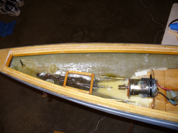

  4. Gettysburg114th

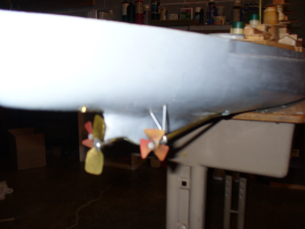

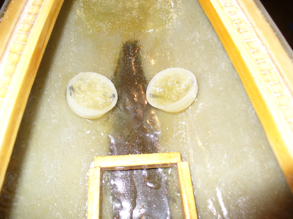

    The struts on the outer shafts have been soldered. Epoxy is now drying where the struts go thru the hull. I epoxied water bottle tops around the struts inside the hull for added strength. I've used this method before with very good results.
    Thanks,
  5. Gettysburg114th
  6. Gettysburg114th

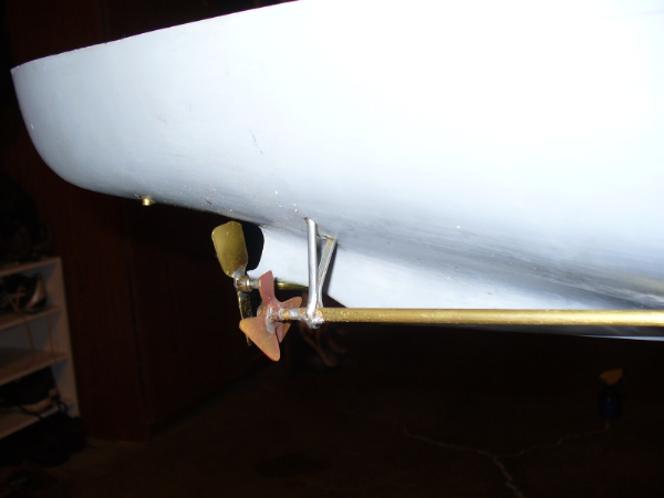

    View of the port strut. The strut is made from a cotter pin. Strut goes thru the hull and is epoxied in place. The cotter pins solder very well.
    Thanks,
  7. Gettysburg114th
  8. Gettysburg114th

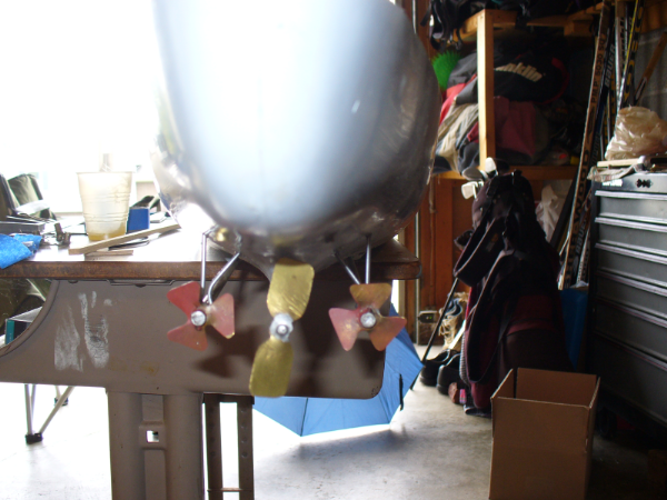

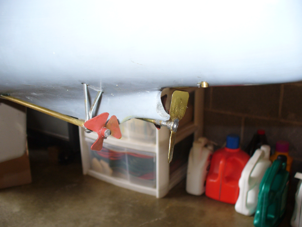

    View of the port and starboard Struts. Notice there are no drag disc. I will not need them as I am using an ESC for both the throttle and the bilge pump.
    I'll try to take pictures after the batteries for the camera charge.
  9. Gettysburg114th
  10. Gettysburg114th
    Starboard strut view.
  11. Gettysburg114th
  12. Gettysburg114th
    An out of focus view of the Starboard strut.
  13. Gettysburg114th
  14. Gettysburg114th
    The struts are epoxied in the hull. I cut the center out of water bottle tops and use epoxy and glass chop. They are in there pretty solid.
  15. Gettysburg114th
  16. Gettysburg114th

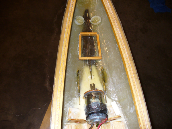

    This pictures shows the area of the rudder shafts, struts, servo box location and the Johnson 970 motor.
  17. Gettysburg114th
  18. Gettysburg114th
    Another view of the same area. You can see motor mounts for the outer shafts should that type of set-up be needed in the future.
    The armor belt can be seen on the starboard side.
